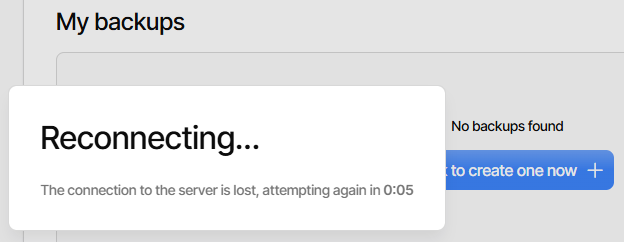

New sort of reconnect failure just showed up. I restarted Windows due to update,
started TrayIcon, and started Chrome. It didn’t connect (usual) but log is different:
2025-12-12 07:46:40 -05 - [Verbose-Duplicati.WebserverCore.Notifications.WebsocketAuthenticator-WebsocketInvalidToken]: WebSocket connection with invalid token

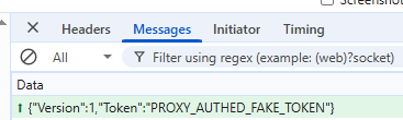

Developer tools has a new look too, although oddly I can’t find this with Wireshark:
PROXY_AUTHED_FAKE_TOKEN is in the ngclient code.
Home page is counting down, but I suppose hasn’t been able to get backups info:
As usual, manual refresh fixes things, but needing that all the time is getting old.

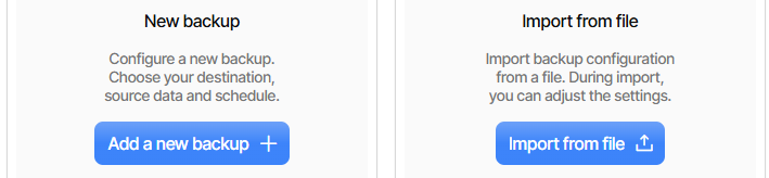

I’m not sure how far back this goes, but on a new install, the Create button says:
and goes right into a hand-edit flow, unlike the other two ways. Is this intended?
Left bar “Add backup” and center section Backups → Create lead into a choice:
