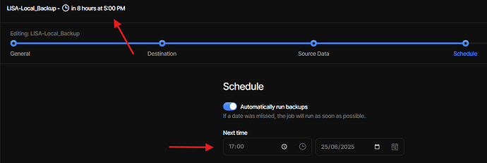

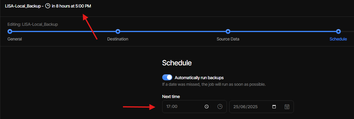

Also, I think you missed one, the next run time - using en_GB:
Damn, I spoke too soon on the date/time formats, all wrong here
That is probably related to a fix where other locales failed to load.
I have created an issue.

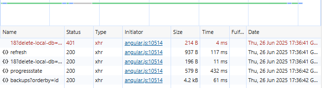

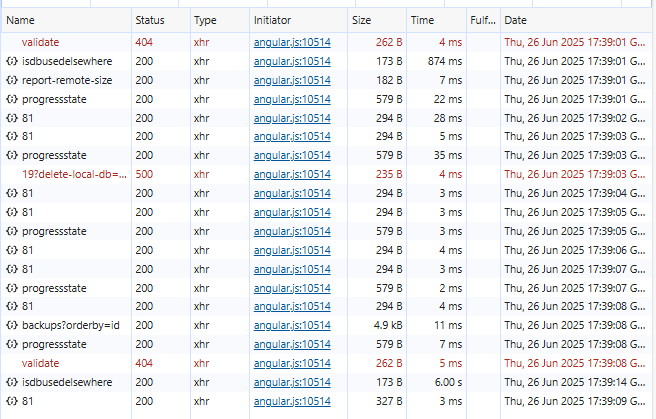

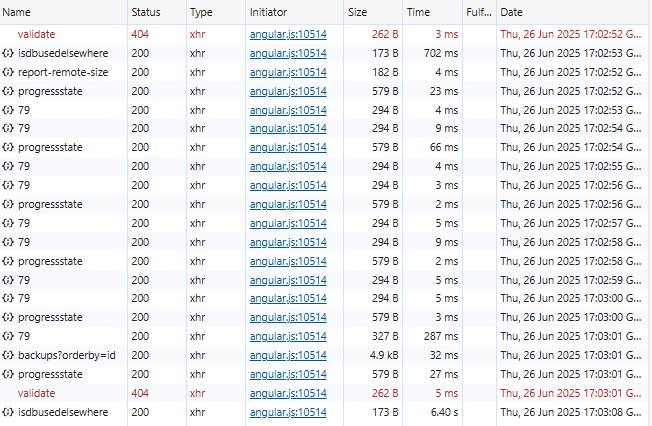

There’s a subtlety to it. When you go into the Delete screen, status says Starting backup, which is probably its known mis-target, but dev tools shows it doing progress polls awhile:
Before I noticed that, I was just going right through and asking for delete, and it was failing. Waiting a short while, e.g. until status bar goes idle, seems to manage to delete the job OK.
In comparison, a kind of fast delete looks like this:

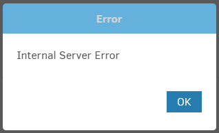

The delete that failed above got “{“Status”:“failed”,“Reason”:“backup-in-progress”,“ID”:81}”
The screen got
The profiling log got

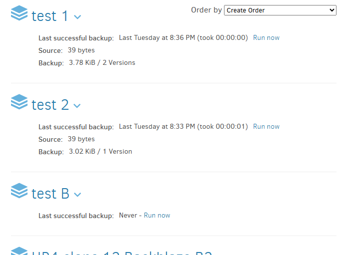

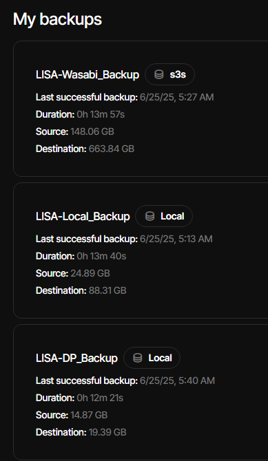

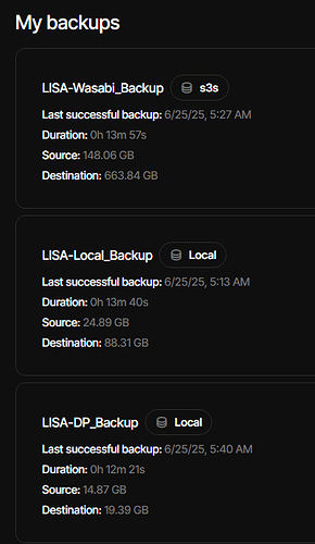

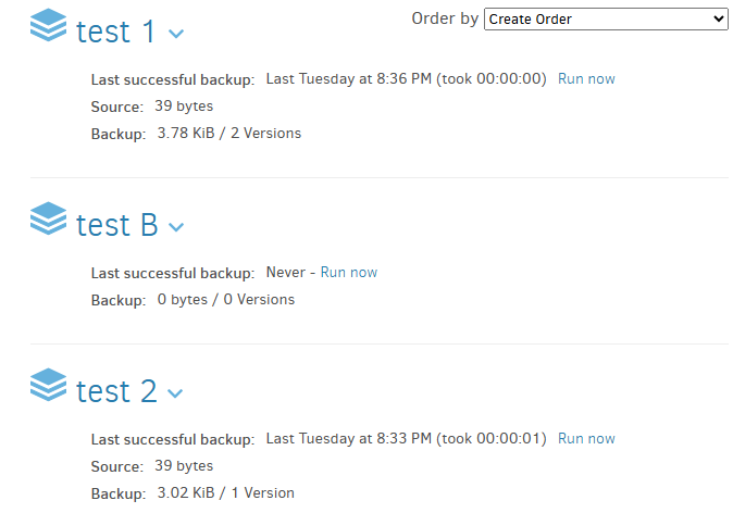

On the home page, a job display order issue is that create order doesn’t actually work.
My first two jobs were test 1 and test 2, then at some point the new one went between:
It’s now at ID 19, and my theory is that the sorting is alphanumeric rather than numeric.
I’ll use ngclient to delete the job, then import+save it again to see where it is on screen.
So that’s another sign that it originally sorted as 1 10 2 5 and has now gone to 1 2 20 5.
Opened issue while waiting for any comments:

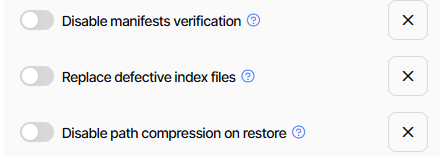

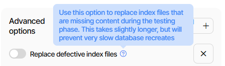

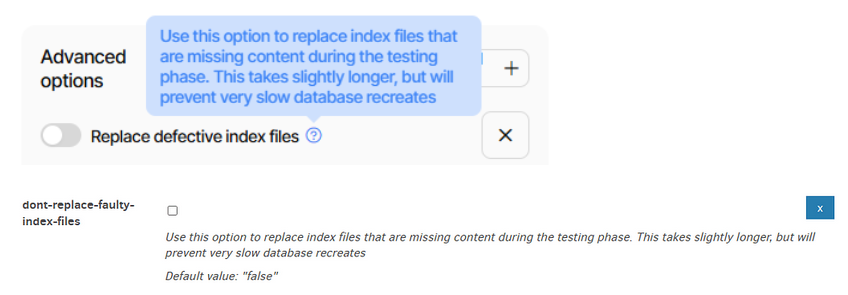

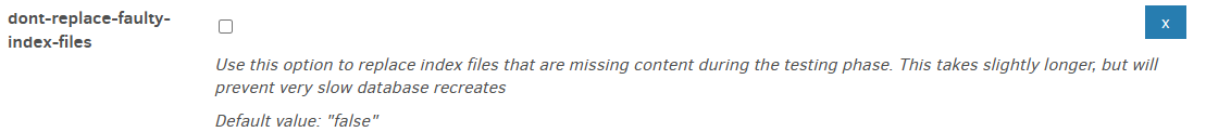

I don’t understand what “true” and “false” mean in this option (Old GUI):
dont-replace-faulty-index-files
Default value: “false”
Use this option to replace index files that are missing content during the testing phase. This takes slightly longer, but will prevent very slow database recreates
I would appreciate clarification on this point, especially since I understand the view in the new GUI to be the opposite.
The dev could probably say more, but Boolean values describes some of the general idea.
A boolean option passed will translate to the value true if it is supplied with no assigned value.
implicitly means (and it’s been more directly said elsewhere) that not giving option is false.
This forces code to choose the default behavior without the option, and here it’s to replace.
If you don’t like that, then add don't-replace ... option with a syntax that means true.
was probably a response to
Ensure booleans are false by default #6333
This PR changes --replace-faulty-index-files to --dont-replace-faulty-index-files, and swaps the default value.
The behavior with no option should be the same, but the way to change behavior changed.
To me, the GUI views look the same, but the help text didn’t change when option did.
I’ll repeat my previous gripe about the new UI not actually showing the option’s name.
I do know what name I chose from the selector menu, but how to reverse the display?
The help made more sense for replace-faulty-index-files idea. It should be changed, however writing to match the boolean false-by-default has a risk of using double-negatives.
One attempt: “Use this option to stop replacement of index files that are missing content during the testing phase. Replacement takes slightly longer, but will prevent very slow database recreates.”
As a side note, the replacement dindex is faulty enough to be replaced again and again, however is probably an improvement for recreate. This has been mentioned a few times.

Additionally, help text is wrong (as mentioned), and option name isn’t shown.
This leaves one entirely reliant on backwards help text to try to understand…
Regarding improved wording, I looked at what some other “dont” options say:
and you can see that the unchanged help still has the wrong direction stated:
The wrong long statements are exactly identical. Let me repost what I showed above:
The difference is old GUI doesn’t show the reversed short help. It shows option name, providing summary of the option. New GUI shows wrong short help, trying to do same.
You are reading reversed help. Don’t do that, or be aware that help here is backwards.
When option got reversed, help should have reversed. It didn’t. It’s backwards.
An option has a name and short and long help. The below were added May 27 for original release of this feature in 2.1.0.119, and were not changed on June 13 with option reverse, which was a coding bug IMO. All you can do for 2.1.0.120 is not rely on the reversed help.
So if the short help text were fixed, ngax would show dont-replace-faulty-index-files option name, and ngclient would show (for example) short help of “Don’t replace defective index files”, and would solve the confusion seemingly being caused by bad 2.1.0.120 help.

I understand the gripe, but I think the actual option name is for power users, and has little value for the regular person. I think the option to have the ... edit as text would solve it, by showing the actual option names.
I see, since the option is now inversed, the wording should also be inversed.
