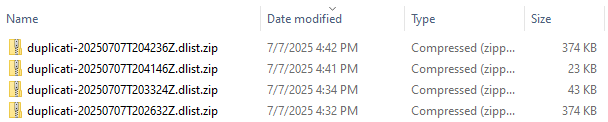

I originally found this on my production backup, where some source files change.
This is a little hard to describe a repro for, so I tried a simple one with no change.
I have a big tree of empty files with multiple folder levels, so I can pick start point.
  • Did a run, got a dlist
  • Did a run, with elevated-auto-VSS on. Interrupted while counting. Got a dlist.
  • default snapshot-policy=Off, did a run, interrupted while counting. Got a dlist.
  • Did a run, got a dlist.

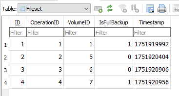

In FilesetEntry, all FileID follow the same pattern of 1 to N. Interrupted N end earlier.

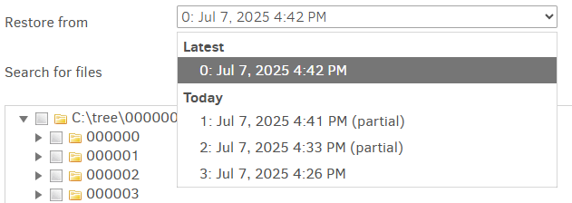

In old ngax UI:

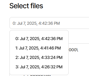

In new ngclient UI:

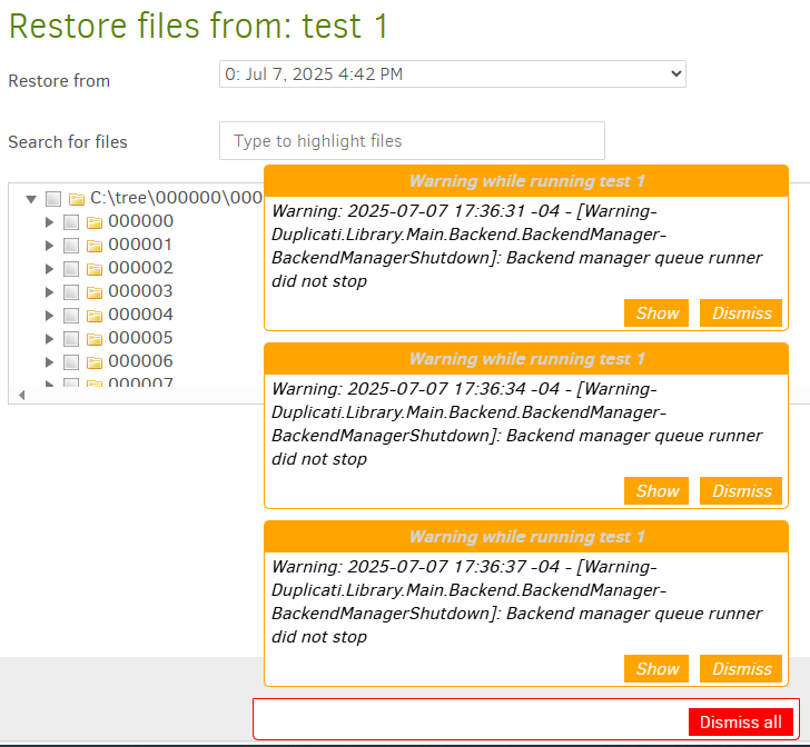

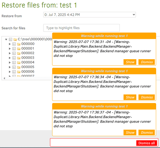

I did get several warnings which are hard to spot in ngclient, but spring up in ngax.
Two “Cancellation was requested by user.” seem to match my Stops, so seem OK.
In jobs logs, four list got warning like this, but I’m not sure what I did at the time:
2025-07-07 16:44:45 -04 - [Warning-Duplicati.Library.Main.Backend.BackendManager-BackendManagerShutdown]: Backend manager queue runner did not stop
Using ngax and clicking Restore at 5:36:30 gets this series. Different issue I suppose:
If I understand correctly, the issue is that ngclient does not show if a backup is partial or not?
If so, I have created an issue for it.
