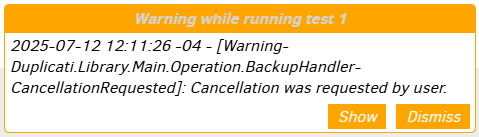

Is the ngax ā€œStop nowā€ supposed to error
instead of the ngax ā€œStop after the current fileā€
Often users think ā€œA task was canceledā€ means they did something. It’s true here though.
I’m actually testing on 2.1.0.124, but the stop issue first began discussion roughly here…
If ngclient stop button is supposed to be like ngax ā€œStop nowā€, it seems to do a lot more, such as uploading a partial dlist file, and it also doesn’t need any changes to cause that.
2.1.0.122 Canary ngclient stop uploads a short dlist file
As evidence of no changes, I don’t have upload-unchanged-backups set, so no backup version and no dlist file is created on a normal repeat backup without any stops before it.
That is up for discussion. It shows the error because internally an error is thrown that activates the shutdown. Since the user is responsible for the error being thrown in this case, it is arguably ā€œas intendedā€ an could be shown differently.
This is just the .Net message for cancelling a task. It does not have any idea what cancelled it. The task cancellation trigger could be a timer, a side-effect from something else stopping, the user, etc.
We can replace the message with another sentence, but I think the underlying issue is that we are lacking information about the cause of the cancellation. We could (do?) keep track of the user issued cancellation and show something different here.
The text ā€œStop nowā€ text seems to be on the commandline UI? My description until now assumed this was considering the status bar ā€œStopā€ button(s).
For some reason there is no soft-stop for the commandline in neither ngax nor ngclient. Both frontends implement the stop here as abort, so they should do the same at least.
Testing .120 again, it looks like I meant ā€œTerminateā€, basically the new faster stop button option that isn’t ā€œStop after the current fileā€ and that has the (new, I think) ā€œA task was cancelledā€ user message.
I had done an early quick test of .125, not seen the problem, so tested .120 (which we’re in now).
Going back to .125 for a test with a longer backup, it’s kind of hung for over 25 minutes now, with
This was actually Terminate, but status message has been wrong even when it was ā€œStop nowā€:
Choose ā€˜Stop now’ but status then shows ā€˜Stopping after current file’

If I duplicate the Edge tab to see if I can get a different look, I can get the stuck status bar to say:
EDIT 3:
In developer tools, this is a ā€œTerminateā€ followed by a ā€œStop after the current fileā€. Still stuck here.
Profiling log did get a new line, probably from the ā€˜stop’ based on time, but without further activity.
2025-08-05 08:04:18 -04 - [Verbose-Duplicati.Library.Main.Controller-CancellationRequested]: Cancellation Requested
Is this the UI that is hanging? Or is Duplicati actually hanging for that long?
It’s closer to Duplicati hanging, but it’s only the job. The UI seems responsive.

Job database time is 7:25:42 and server database time is 8:13:03. I’m not sure when process actually went down. I noticed it later when I went to use it and it wasn’t there.
I wouldn’t have intentionally Quit it, as this was my uptime leader. Lots of threads and handles accumulated – and I don’t know if that could be a factor in it getting in trouble.
The UnobservedTaskException is a bit of a pain, because they happen when some detached code has an error, so the context is not really known.
From the ones there, I do not see any dangerous ones. Attempting to access a disposed object is usually done during some cleanup, and the retired channel is also expected when shutting down some code.
I don’t think these are the cause of the crash, but they are most likely lingering and then being cleaned up due to another crash that brings the server down.
This one points to the TrayIcon’s connection to the server. The wait handle is disposed when the server is closing, so this indicates that the server was stopping (for some reason) and the TrayIcon does not handle this gracefully. The code in question was updated for 2.1.1.100, so at least that error message should now be gone, but it does not explain why the server stopped.
