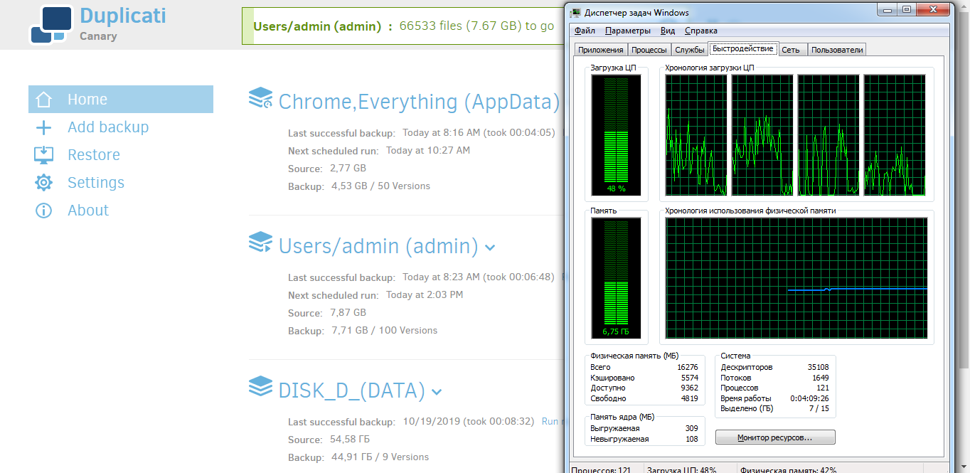

The CPU takes off up to 45-60% during the start of the backup task.
Then the CPU drops to 6-10%
Watch Task Manager during the slow spot to see if your CPU or HDD looks more like the limit.

Here CPU load of 50%
Still waiting for HDD info (see Task Manager Performance tab). That’s an easier way to get a perceived-by-user system slowdown, especially because your Duplicati settings have --thread-priority=idle (right?). Task Manager right-click can also adjust priorities (but I haven’t tested it).
What exactly is freezing? Some app? Windows itself? Task Manager and screenshots still work.
You have half your CPU power idle, and Windows should be using it – unless HDD is the issue.
Do you know what CPU you have? You can get information at Task Manager Performance tab.
