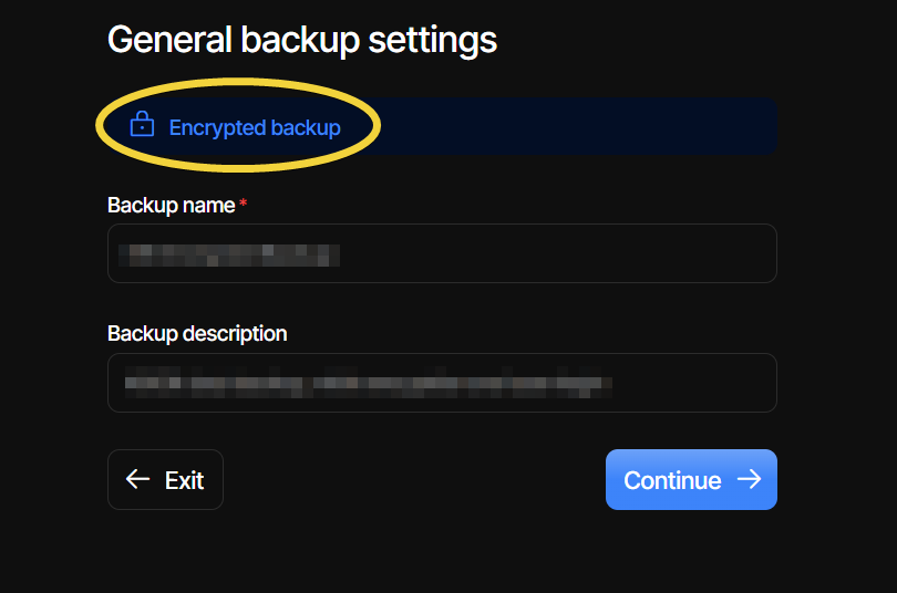

I just updated to 2.2.0.0_stable_2025-10-23 and just got a warning that my Database is Unencrypted. I was going to post this in this thread, but since I am a layman, I thought to start a new thread, as that one is talking about editing .json files (which I’m not comfortable with).
From the prior version (old UI), I created an Encrypted Backup which ran swimmingly. :+1:
However, after updating Duplicati, and it running a few automatic backups, I got the Unencrypted warning today.
I checked the settings of the backup and it shows that it is performing encrypted backups.
When I updated Duplicati, I did go into the backup setting and add/remove a couple of folders, but as far as I know, I did not change any other settings.
Is there something I could check to make sure that my backups are encrypted?
Thanks for any help!
