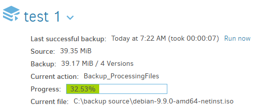

Going back to .125 for a test with a longer backup, it’s kind of hung for over 25 minutes now, with
This was actually Terminate, but status message has been wrong even when it was “Stop now”:
Choose ‘Stop now’ but status then shows ‘Stopping after current file’

If I duplicate the Edge tab to see if I can get a different look, I can get the stuck status bar to say:
EDIT 3:
In developer tools, this is a “Terminate” followed by a “Stop after the current file”. Still stuck here.
Profiling log did get a new line, probably from the ‘stop’ based on time, but without further activity.
2025-08-05 08:04:18 -04 - [Verbose-Duplicati.Library.Main.Controller-CancellationRequested]: Cancellation Requested
