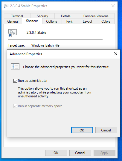

FWIW (and I wish it wasn’t necessary), I do that the clunky way with this on shortcut:
This brings up UAC prompt. After satisfying that, shortcut runs a batch startup script, which leaves a terminal window around. If it fails that way, maybe it’ll say something.

I solve my VSS issue by starting from a batch file, so answer a UAC prompt:
Having shortcut do escalation was more flexible for me, but Windows Service
possibly could also do the job, but it’s a bit awkward to attach tray icon to that.

Starting GUI via desktop icon (right click → run as administrator) does work. I take it that by “terminal” you refer to Windows’s cmd.exe? I could do that, but neither way serves for the automation I want. In fact, manually starting is what I do by now.
