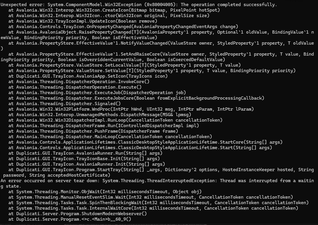

Got an answer - by running in terminal it did indeed print some stuff before crashing:
Ideas?

Thanks for the trace. Based on some searching it looks like this can happen if too many handles are allocated, indicating some kind of leak. I noticed that we do not properly close the image handles, so it could be some weirdness where the icon is repeatedly updated, causing many images to be loaded and eventually running out of handles.
I have added a PR that caches the images so they only consume a single handle each, even if they are loaded multiple times.
