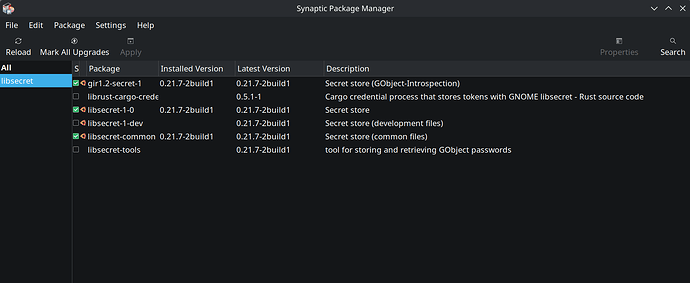

Thanks for your fast answer! I checked on my “Live” System (Kubuntu 26.04) and in synaptic the libsecret-1-0 is installed (see screenshot). I also checked it on my “Test” System. It is the same as “Live” but I can launch 2.3.0.1 there without a problem…

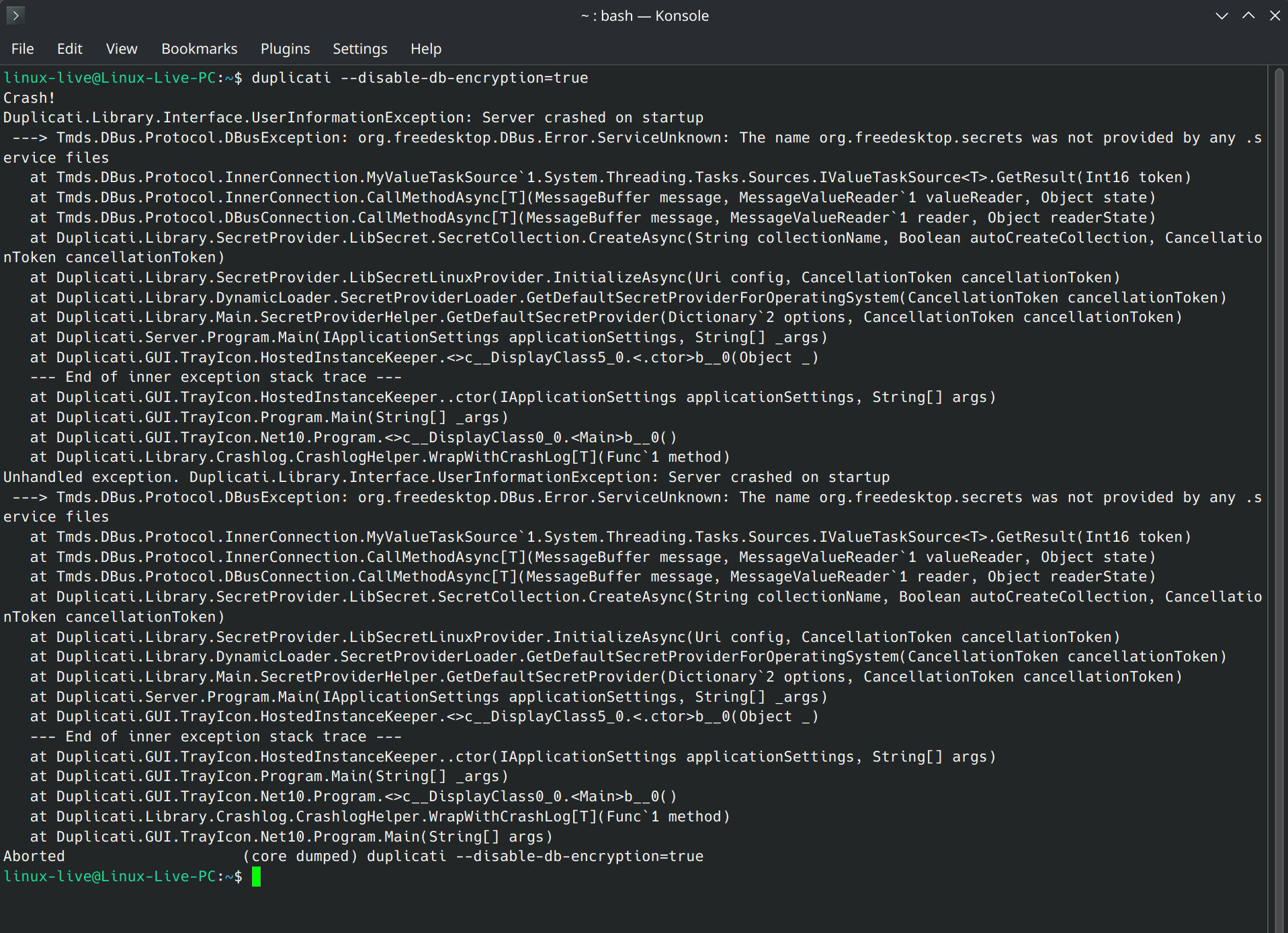

When I launch 2.3.0.1. on my “Live” System in the Terminal: “duplicati --disable-db-encryption=true”. It didn’t work and crashes…
