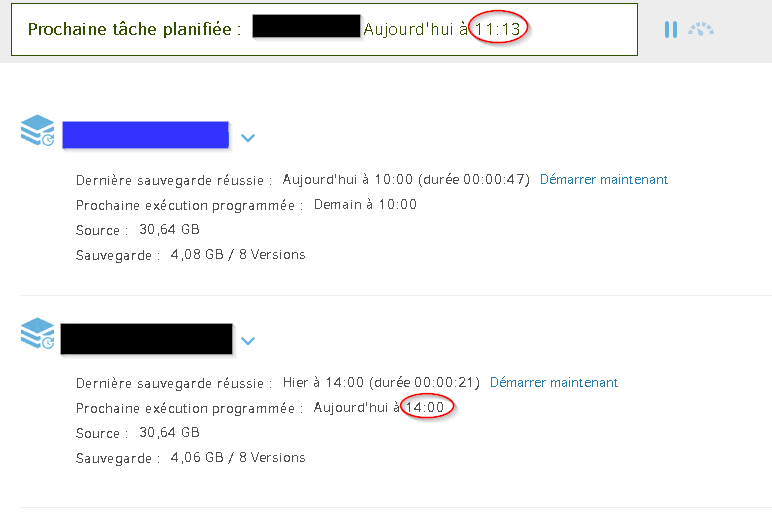

I’m heavily suspecting that the timezone is the issue here. I’m in EST -4, and the Schedule table shows ‘Time’ as a timestamp (and the error logs also mention it in UTC). I believe Duplicati is comparing this UTC time to the non-UTC system time.
Here’s an example of the described bug:
The next scheduled backup is at 14:00 EST -4 (which is 18:00 UTC). This is stored in the database in the “Schedule” table, in the corresponding backup’s row, in the column “Time” as a timestamp (which are always UTC).
Backups are scheduled to run every 2 hours. The next backup would be at 16:00 EST -4 (which is 20:00 UTC).
In this instance, I believe any interval equal or below 4 hours would fail. This is equal to the timezone difference between UTC and the system.

I just checked and it is wierder than that. At 14:32, the schedule runs with an “every 23 hours” set. It runs, but for some reason, it sets the next scheduled time to 23:00 of the same day (today) ?
I am just confused now.
