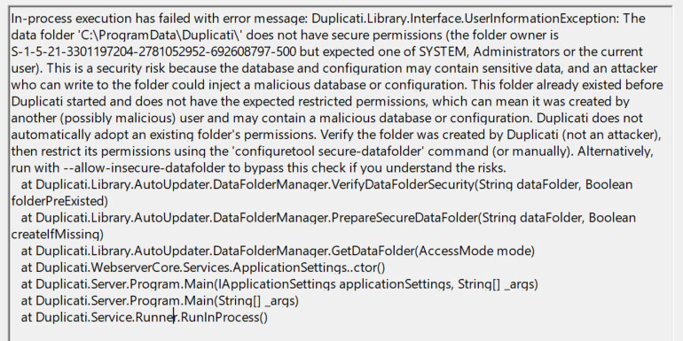

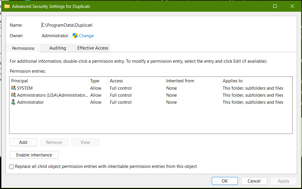

Ok, sorry, already hating the new locked down folder.
I see nothing wrong so why won’t it start? This is Windows Server 2025 (domain joined).
Forgot to add, the tray icon was complaining first, so when that ran after the command I thought it was done, but the service won’t, which runs a local system.
Thanks for reporting this. I think it is a logic bug, that happens when you run the configure tool with elevated permissions. It assigns the current user (an administrator account) as the owner, and then the check fails because that owner is not in the permitted set (Administrator (group) or SYSTEM) once the service starts.
The screenshot does say “Owner: Administrator”, but that is not the SID that Duplicati finds as the folder owner. The SID that Duplicati reports looks like a local administrator SID.
I will update the configure tool to handle this with a --for-service option. For a fix, there are two ways to do it.
The simple fix is to run
Duplicati.WindowsService.exe secure-datafolder
This will restart the service and ask it to set the permissions. Since this runs in the service context, it will set the correct permissions.
Alternative is to edit the setup, remove the “Administrator” entry from the permission entries so it only has “SYSTEM” and “Administrators” (note the trailing s). Then change the Owner to be “SYSTEM” (or Administrators).

Thanks, using Duplicati.WindowsService.exe secure-datafolder the problem was sorted.

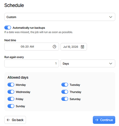

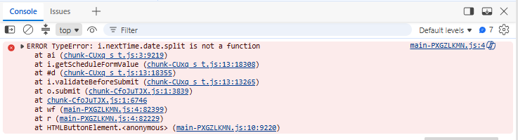

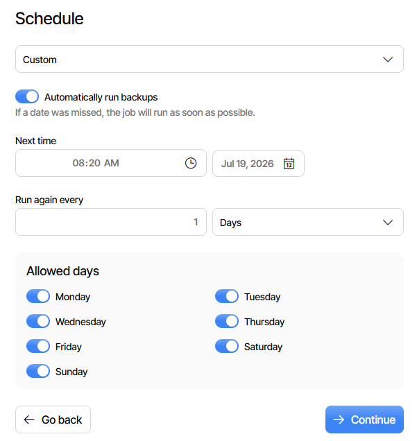

Basically, I can’t Submit. Nothing on net. Haven’t played with it much.
Workaround is to use old UI via Settings to do import. It gets July 19.
Go back to new UI and look at what job got for Schedule. It’s July 18.
What came from the server to show that:
        "Time": "2026-07-19T12:20:00Z",
        "Repeat": "1D",
        "LastRun": "2026-07-18T12:20:00Z",
Good news is it seems less prone to run due to a past-due schedule.
Bad news is trying to set a further future date (July 20) is rejected too.
EDIT 3:
Also rejects older past dates. Changing to 1 hour repeat, same result.
Visual appearance is Submit button is ignored (so check in dev tools).
EDIT 4:
Bug seems new for this Canary. 2.3.0.106 lets me schedule a backup.
2.3.0.107 new UI basically doesn’t, though it did let me do 13:00 Daily.

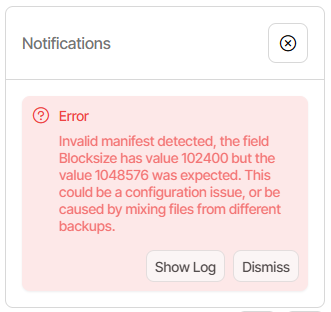

Trying “Store configuration with backup” announced in 2.3.0.105. First try said:
Error
Invalid manifest detected, the field Blocksize has value 102400 but the value 1048576 was expected. This could be a configuration issue, or be caused by mixing files from different backups.
I think the problem is that backup began in 2.0 era, so is still using old blocksize.
There is no explicit --blocksize given, but I think DB knows what it has to use.
I think recreating the DB also figures this out somehow from the destination data.
“Import from destination” feature seems confused. In terms of reporting, both the Alerts and Notifications icons turn red (not used to seeing that) and give the error.
The claim about manifest is correct, but the expectation is off. With DB, one has
but I suspect a DB isn’t involved in this case. It’d still be nice if it figured things out.
Another way to get error is by explicit blocksize option, e.g. for an oversize 5MB.
I think the DB recreate adaptive code is the call to UpdateOptionsFromManifest, basically taking what the Destination has, rather than expecting the current default.

Yes, that is exactly it. When reading the remote file, Duplicati will compare the local (default) settings to the settings recorded in the manifest. If these do not agree you get an exception message saying “invalid manifest”.
For the next version, the manifests are fully ignored when restoring the configurations.

Thanks, anything more I can try for my broken backup?
I was mostly worried about program directions to user being for the wrong OS:
There is no such program on my Windows system. This will confuse the users.
meant directions to the user on what command to run (which varies by the OS).
If dynamic is hard, at least explaining both names is a crude but simple method.
This is equally true of explicit permissions, isn’t it? Aren’t they always verified?
Although a slippery slope may occur, this icacls output looks trivially different:
Accepted:
. NT AUTHORITY\SYSTEM:(OI)(CI)(F)
  BUILTIN\Administrators:(OI)(CI)(F)
  PC\User:(OI)(CI)(F)
Rejected:
. NT AUTHORITY\SYSTEM:(I)(OI)(CI)(F)
  BUILTIN\Administrators:(I)(OI)(CI)(F)
  PC\User:(I)(OI)(CI)(F)
The rejected one is inherited, and is actually a subfolder of the accepted folder.
Without knowing coding way, I don’t see how rejected one is hard to recognize.
OTOH I’m not sure how often the problem will come up for others. Time will tell.
