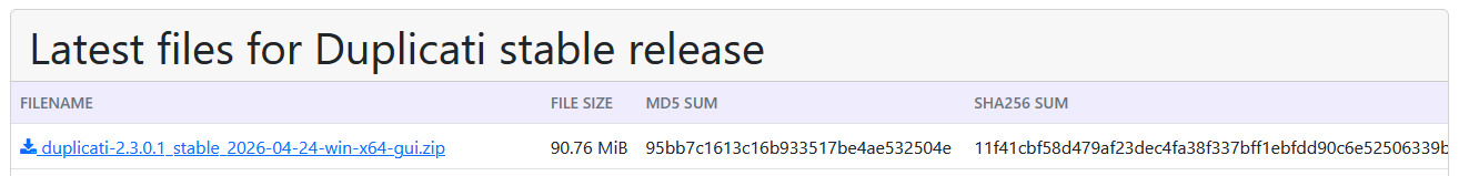

I’m not sure in which version it change, but Duplicati on github is no longer duplicati, but duplicati-agent and duplicati-gui.
That difference should be way better communicated and described on the github page.
Not wanting GUI as I run duplicati as a service, I installed agent only to find out it’s something else and want’s web authentication. No idea to what. It doesn’t tell anywhere. There was option to start it upon user login, but that’s not the service that I would like to start with the system.
Quite confusing and no mention in changelog about that.
Fortunatelly, it did not nuked my existing install of 2.2, so I was able to remove it and install GUI version. Which doesn’t talk about service either, just about user loging in, is not able to stop the running service (which fails install or requires reboot), does not offer to install/start it.
Scared me for a while…
That is described here:
Agent is something else, it is for installations where you only want to manage the instance via the Duplicati console.
The introduction of the Agent was quite a while back, so there is no longer a mention of it.
The Agent uses it’s own installation folder and data folder as the Agent install could live side-by-side with a regular desktop install on a shared machine.
My scenario would be “The Server” (running it as a service with local webserver), but that option is not available in releases on GitHub.
Only TrayIcon (which is called gui on release page) and Agent (there it’s the same).
So to install/upgrade “The Server” I’ve to guess which one (it is the GUI one - which is not intuitive if I want service - with one time setup of the service) and then manually stop the service before upgrade and possibly start it after install (I haven’t waited if the trayicon option starts it and just started it).
If we leave out the Agent which is different, the two other options are GUI and CLI.
The only difference between the two is that GUI includes the TrayIcon (a few kb) + has dependencies for that, which requires some kind of desktop environment.
If you have a desktop environment on the machine, you can use either package as they contain the things you want. If you are on a headless machine and do not want to pull in a full desktop as dependencies, use the CLI package.
The CLI package is only introduced to support installation on systems with no desktop environment.
seems a better resource for package picking, but I wish it was easier to find.
Somewhere really close to the large list of packages would ease that choice.
Possible easy solution is a README.txt or something that sorts high on lists.
Doing better might be possible, especially on Duplicati’s own download page:
This is for those who don’t like what main page offers which is named gui.
It’s the complete one, sort of a superset of cli (which actually has server).
Nothing forces a user to use an included component which they don’t want.
What’s confusing is the relation between “ways to run” and a package type.
In one sense, that one time setup is probably through the web GUI I’d guess.
That’s actually not the GUI the package has in mind, as a browser displays it.
Linux in “Package options” talks about cli case for server without a display.
There they could browse from display-equipped system to remote web server.
Windows users who run Duplicati as a service might still use a tray icon. See:
Combining Server and TrayIcon. Basically, there are lots of ways to assemble.
Easy way in is TrayIcon from duplicati.com Downloads. Others need plans.
Plans then need documentation read. I wish relevant docs were easier to spot.
I’ve been asking for the release notice to be nearer the download area as well.

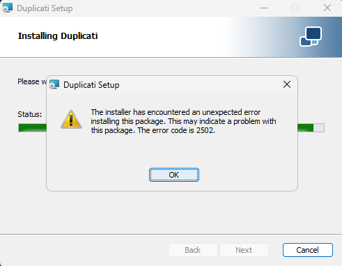

2.3.0.0 GUI installed fine on my Windows 11 machine, but duplicati-2.3.0.1_stable_2026-04-24-win-x64-gui.msi fails with error 2503 and 2502. Am I the only one?
Hi @DupUser, welcome to the forum :waving_hand:
So far, you are the first to report this I think.
Could you try something like this on the commandline:
msiexec /i "C:\Duplicati.msi" /L*V "C:\install.log"
Then just click like you usually do, and after it fails, you should see the install.log file.
If you post this file somewhere and share a link (you can DM me) then I will take a look and see if I can guess the reason.
If you prefer to just move forward, it usually fixes things if you uninstall the previous version first, and then install the new version.
