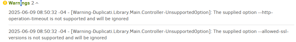

was listed under ngclient, however the bigger question is did options get moved or killed?
Options like http-operation-timeout and allowed-ssl-versions are gone in the help.
We should use a common module that defines the possible arguments, so each backend can pick the options it supports. Each backend can then report the options it supports without needing to expose all options.
but if this was done, it seems to not be working. Any user impact should be clearly noted, however ideally it would still work without requiring any migration work for previous setup.
is probably not critical to my backup, but I think some people are still needing such options.
