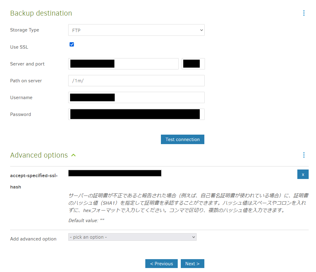

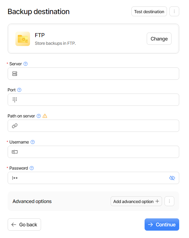

New UI's destination pane is blank for existing FTP jobs
When using the new UI to edit a backup job with an FTP destination, all of the fields on the page are blank, even though the backup works, and the fields show up properly on the old UI.
It appears that the advanced options are also missing from the new UI.
Is this a known issue?

Interesting. Indeed, if I create a new FTP job from scratch, I can’t reproduce the issue.
However, taking a look at the browser console (Firefox on Windows 10) while using the new UI, I see a big error get spit out when I move from the General to the Destination page on one of the FTP jobs where the destination data is blank:
Error while parsing target path URIError: malformed URI sequence
