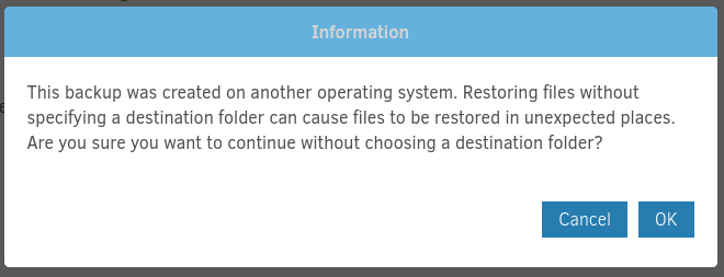

Did you test? It used to say “This backup was created on another operating system. Restoring files without specifying a destination folder can cause files to be restored in unexpected places. Are you sure you want to continue without choosing a destination folder?”
That’s been there since 2017, however it would have been in what’s now considered the old UI. Question would be whether it got put in the new UI…

ngax pops up
and if I decide to OK anyway, pops up
which is what I get for ignoring “unexpected places” note that ngax gives and ngclient doesn’t.
