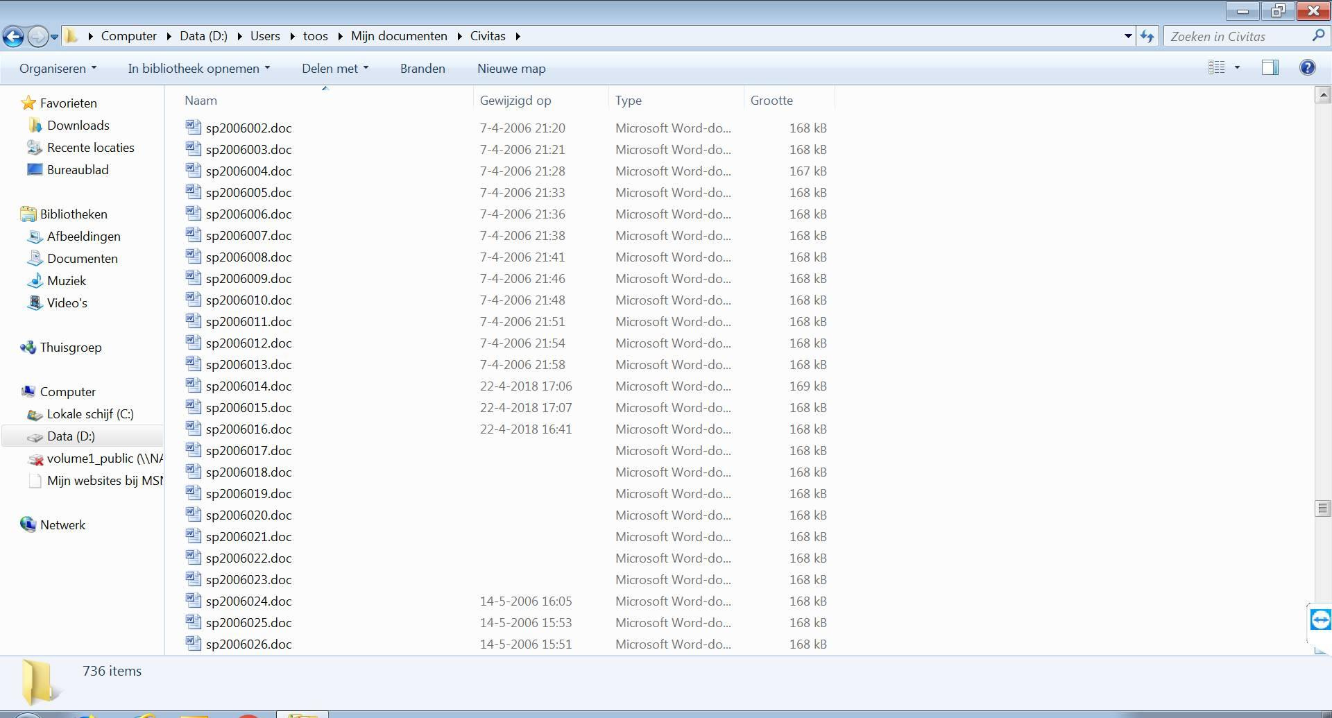

The Modified timestamp of these files is empty somehow, as is visible in the Explorer view below:

I suppose for an empty modified timestamp (as seen in @p_vestjens image above) we could “coalesce” to DateTime.MinValue. This wouldn’t help with @mr-flibble’s year 30826 issue but it would be a start.
The drawback is that a restored version of this file would have a different timestamp than the original. Is that something we’re OK with? Alternatively, we could use .MinValue as “special” to mean don’t write any modified date (if that’s even possible). Of course I’m assuming there are more files with empty modified dates than a date of midnight on Jan. 1, 0001…
