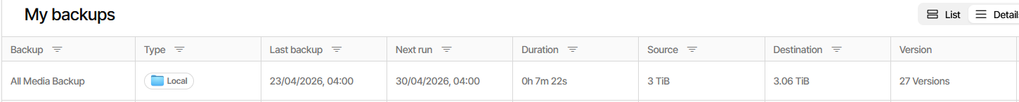

So, the backup destination location is a local unassigned disk on the unraid server; itâs 14TB with about 7TB free. Itâs mapped to the path /backups in Duplicati, from /mnt/disks/.
The 3TB could be the size of the source and desination of the media backup:
