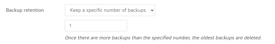

Then you can look at the Options screen to check Retention policy and advanced options.
Duplicati has an allow-full-removal option to use if one really wants to delete ever dlist file.
It would be interesting to guess at how many dlist files there were before dropping to zero.

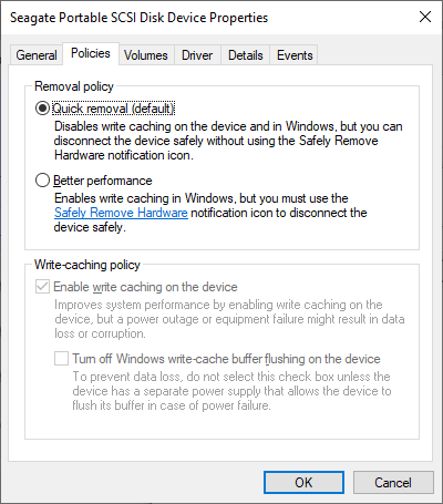

That might be bad and good. USB hard disks have risk of file loss if removed at bad time.
Although its value depends on some settings, there’s a Safely Remove Hardware button.

To elaborate on that, Microsoft documents how Manage default media removal policy works.
On my Windows 10, a USB drive looks like this, but I use Safely Remove Hardware anyway:
If write caching got enabled, but Safely Remove Hardware isn’t used, late data can be lost.

Word in singular is a clue that you configured only one. There’s little point, and it’s dangerous.
Having even two versions (each additional one is usually little extra space) would reduce risk. Multiple version backup also makes it easier to restore after damage not immediately noticed.
