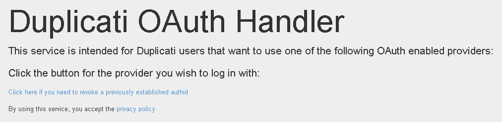

Looking at the documentation, I went to https://duplicati-oauth-handler.appspot.com but could not see a button for pCloud on the default page.

I thus visited that URL which is the same as before but with the type indicated. Sadly, this gives me an empty page, with no button at all:

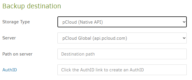

If you use Duplicati GUI, try the AuthID button:
To get into details which the dev might want to comment on (e.g. for release 2.2 plans):
is sending you to new C# OAuth server at https://oauth-service.duplicati.com/

I see, the commandline is using the general Url, which does not work for pCloud.
We are working on migrating away from that solution, so that service has not been updated with pCloud.
