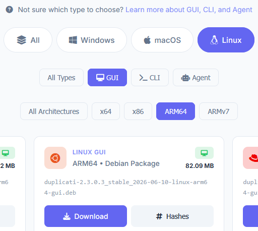

Thanks to Kenkendk I was finally able to get to the download site. The issues seems to be with me and my laptop (Win 11), but worked from my phone and another PC (Win 10). Research and a virus scan in progress…
So, given my plans, I downloaded this .deb file: duplicati-2.3.0.3_stable_2026-06-10-linux-x64-cli.deb. I hope it is the right one for Linux Debian and just the server and cli functions. I will be local to the old server in 2+ weeks, at which time I will start the installation on the new Pi4-Trixie setup. Installation will be via
sudo apt install /mnt/usbdrive/duplicati-2.3.0.3_stable_2026-06-10-linux-x64-cli.deb
