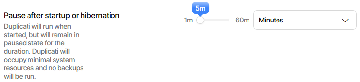

I don’t know how well it was working back then (and there was a recent fix), but
might be the easiest way for Duplicati to not actually get active before time is set.
