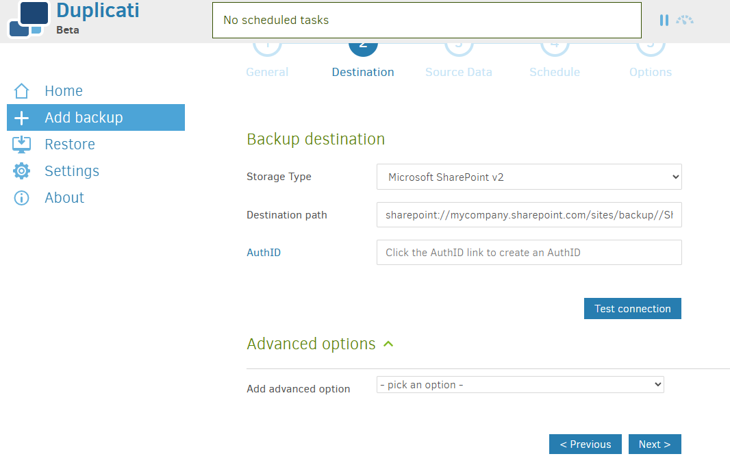

I am trying to set up my Nonprofit Office 365 with Duplicati in OMV where backup from my Odroid goes to Sharepoint. At first, I chose Sharepoint (not v2) and entered my credentials and the site and everything, and the test connection went fine. But there were errors when backing up. Someone in a forum suggested migrating to Sharepoint v2. But I can’t get that to work either. There is a bug where my old username and password are in the destination url, so I copied it, edited out the username and password (and left the oauth) and imported it back in. I’m still getting “Failed to connect: No site ID was provided.” I tried deleting the whole backup and starting over, but no dice.
In “Destination path,” I have tried mysite.sharepoint.com/test/ as well as mysite.sharepoint.com/test and https://mysite.sharepoint.com/test/ and https://mysite.sharepoint.com/test and just /test/ and /test and test. Nothing I put in there will work!

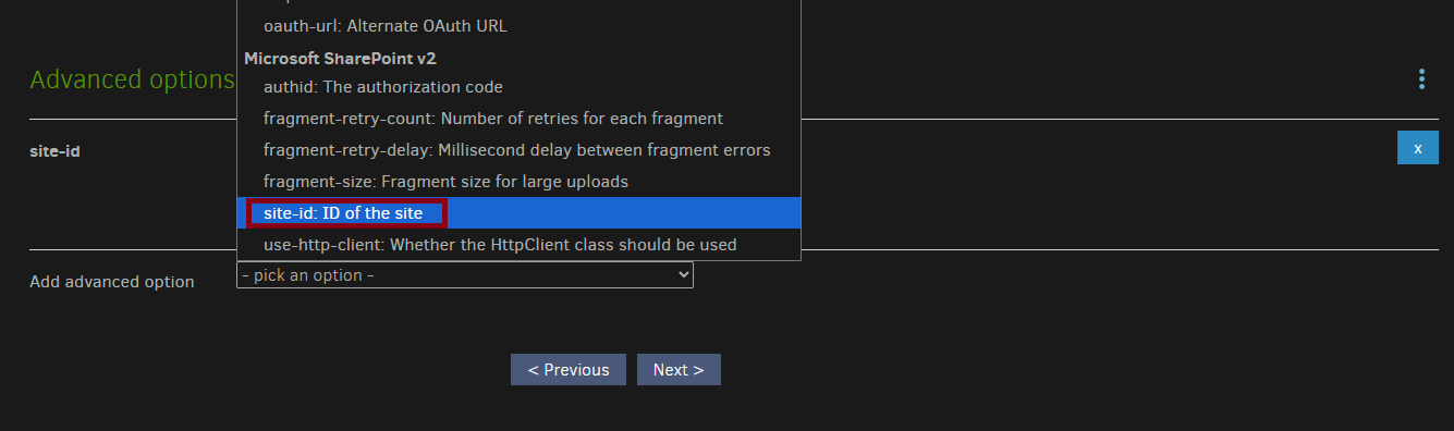

Then in Duplicati, for Destination path, I just put a name for a folder that I want all my backup to go into, and added my AuthID. Under Advanced Options, I chose site-id, and pasted the site ID that I had copied from the Graph Explorer.
I did a test connection, and it worked perfectly!

You can select the item “Site ID” under “Advanced Options”.

add the site id field from add advance option site-id

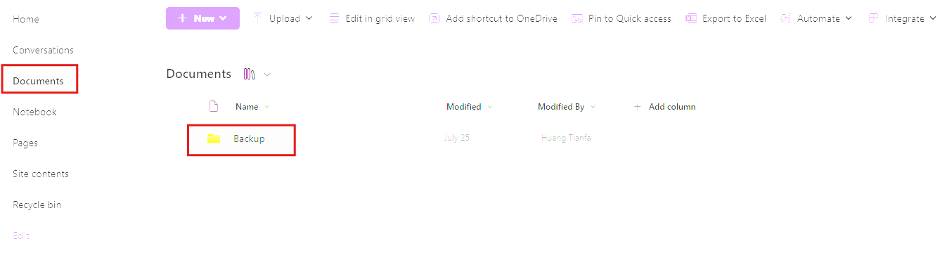

e.g you want the backup to be in the backup folder
you will fill in like below
Storage Type : Microsoft Sharepoint V2
Destination path: /backup
Auth ID: {your auth id}
site-id : {your site id}
now you can click on test connection, a popup will appear asking to create the folder if its not created yet, volla, you are done
