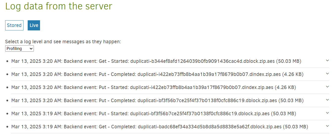

This job has also started behaving in another strange way. When the job got stuck, I eventually terminated the Duplicati process and then restarted it. When the job in question finishes, it still wants to compact, but the compaction process is behaving strangely now. Usually during compact it will follow a process like this: Get, Get, Get, Put, Delete, Delete, Get, Get, Get, Put, Delete, etc. as it pulls down files, repacks them, uploads them, and then deletes the originals.
Now, when it compacts it is downloading and uploading, but there are never any deletions. I eventually stopped the job and disabled compaction as it had been running for a very long time, and I didn’t have time a the moment to play with it.

The way the compacting looks now, is that it will wait until the end before it deletes files it does not need. I assume it has been that way for a long time, but I think @ts678 was also pointing out that this was new?
was the same early conclusion that was solved after hearing deletes are at end.
is my concern about what that means. This hits super hard if remote volume size change causes compact. Dealing with full destination was tough even before this. Previously if one could free up a tiny space, compact could make more. No more.
The behavior seems new to me - I had assumed that the compaction process had always been get/put/delete.
Is there a technical reason to leave all the deletions to the end? I suppose it is safer by some measures… but as @ts678 says, it can make dealing with space-constrained storage quite a bit more difficult.
Pretty new. The link I cited gives (further down) the date and the 2.0.9.109 note.
The pull request cited in above link gives explanation, but it’s long and technical.

I think that was the logic. Avoid complicating things by removing files before we know we have a good state. But… we know we have uploaded everything needed when we mark the old file for deletion, so it should be safe.
Thanks, I will prioritize this.
