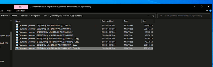

hello guys, i started to use unraid, i downloaded duplicati from the apps tab but now i have a question or problem,
i created a test folder
i connected my google drive

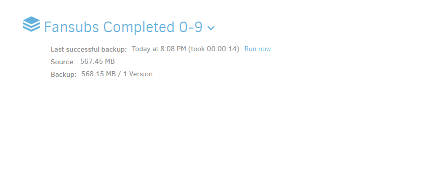

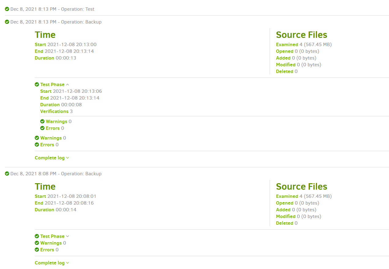

i uploaded the original, they are on drive now, but if i add a file or delete a file and run the backup again i see no changes, not on one drive or the logs and it don’t say it have any errors,
i don’t know if these screenshots are any use full
but it feels like duplicati dont reconize the extra files ? i also copied a other file maby it is because hashing but it didn’t update the backup on google drive and it stay on 4 files checked

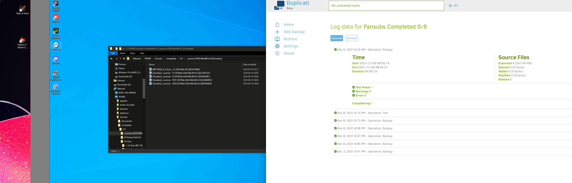

seems the backup also don’t show the copies
You’re right, it looks like it doesn’t detect that there are new files. Very puzzling!

Duplicati scans the filesystem each time the backup runs, no need to restart it or the server to get it to recognize new files.
Something weird is going on here, that’s for sure.

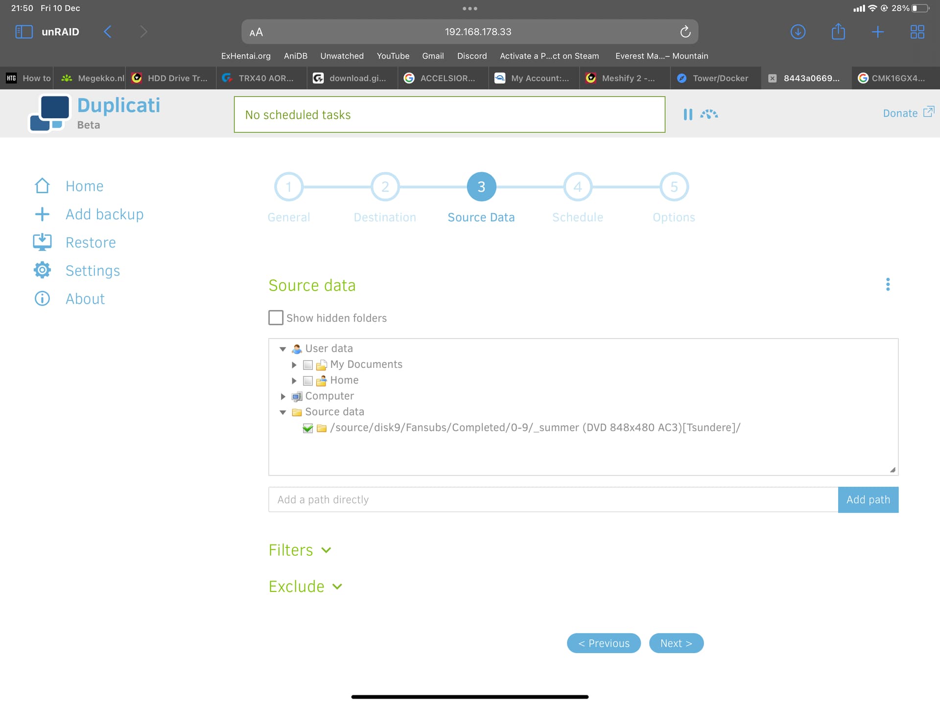

A similar test would be to see if the files look right from Duplicati’s perspective on its Source screen.
On the Source Data screen 3, view folder again to see what’s visible and checked there and below.

I assume Creating a new backup job shows what you once did. Edit the current job, go to screen 3 where you selected your Source Data folders and files (see the manual for an example), look at your folder and files. Do you see the “missing” files? What’s checkmarked? If it’s not checkmarked, it won’t be backed up.

I literly dont know how or what , i don’t see anything what you guys mentined
If you expand “Computer” in that tree view, do you still see the “/source” folder and all its content?

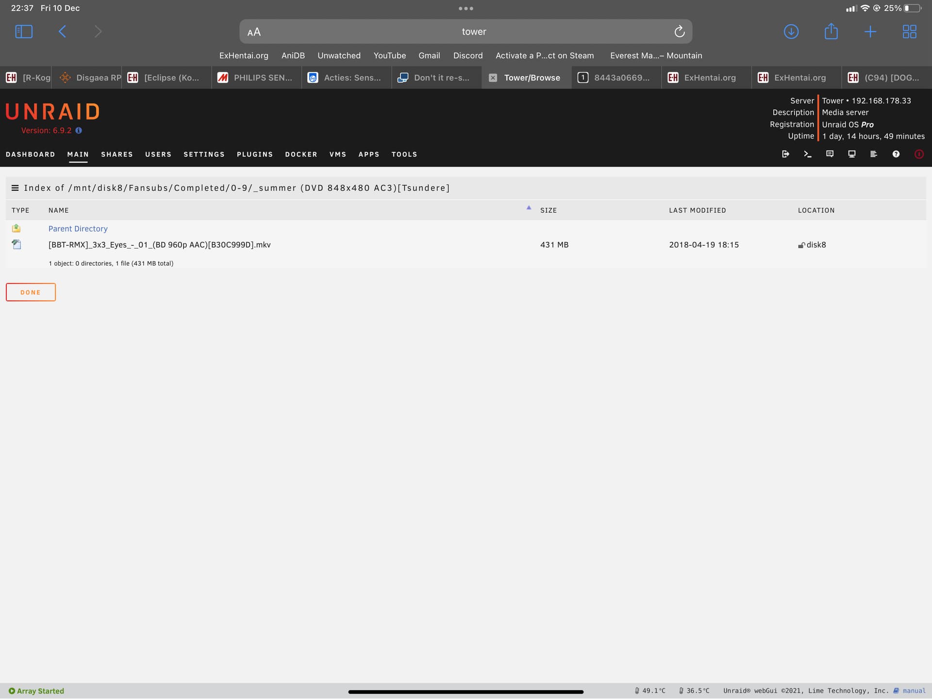

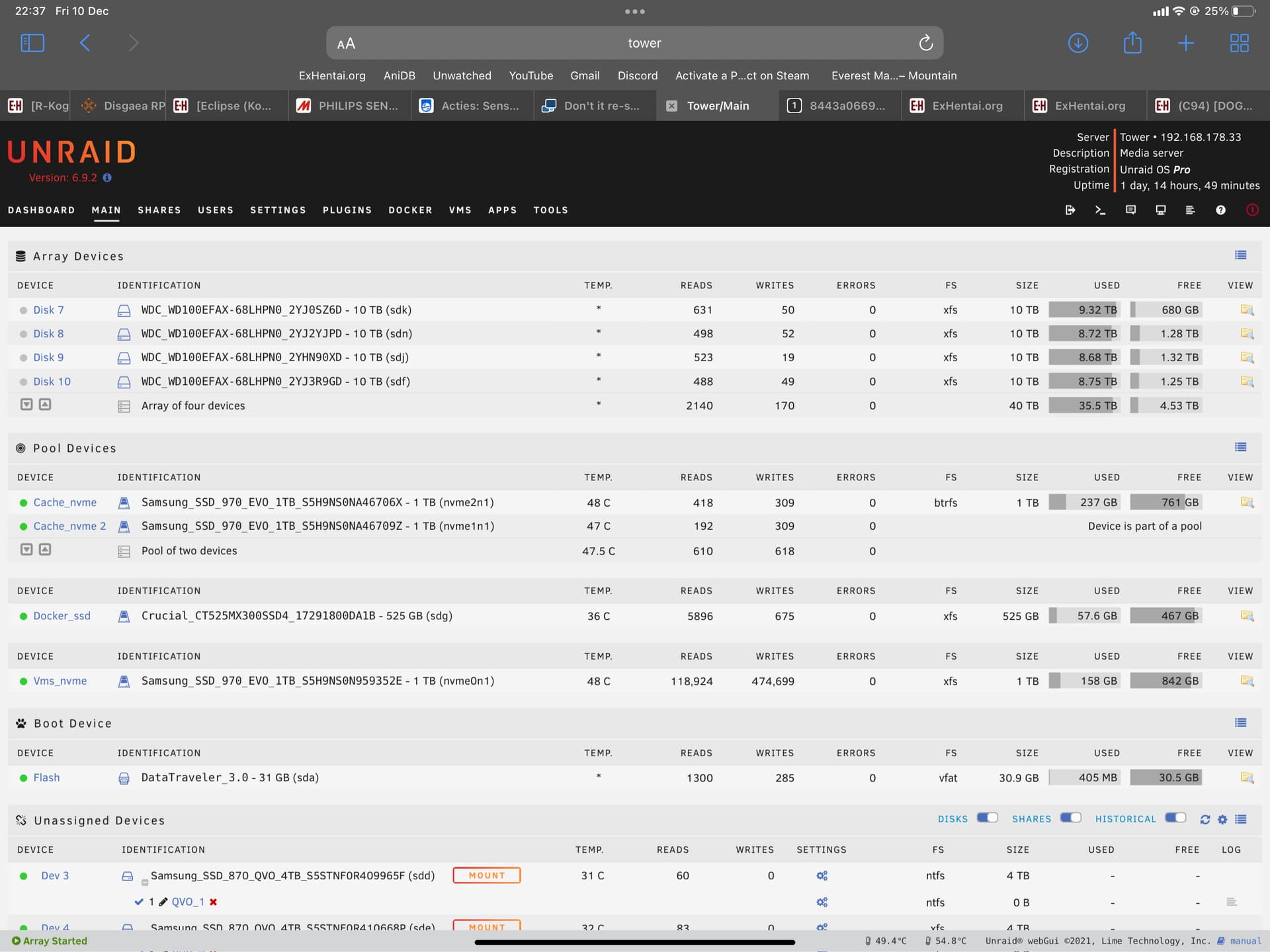

I cant expand it, atleast not on my ipad, i probaly kind of know what is wrong, it dont sync the folder because unraid putted the new files on a other disk, but same folder name,
Unraid fills the drives equaly , like if one is 80% and other 70% it fils the 70% till 80 then move on to the next, i don’t know what it is called atm
Shares in the Unraid manual talks about user shares and disk shares which all exist under /mnt. The Duplicati How-To and the video it points to suggest /mnt/user be mapped to /source which I guess ensures you only get the merged view. The manual refers to a configurable allocation method to control which disk gets the new file.
I haven’t looked into this enough to know when one might prefer to backup disk shares, as you might be doing.

You definitely want to configure user shares in Unraid. This makes it so that the actual drives the files are stored on are “hidden” from the client. The client just sees directories.
