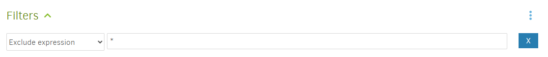

If initial backup isn’t opening any files, then make sure the job Source screen isn’t over-filtering:
