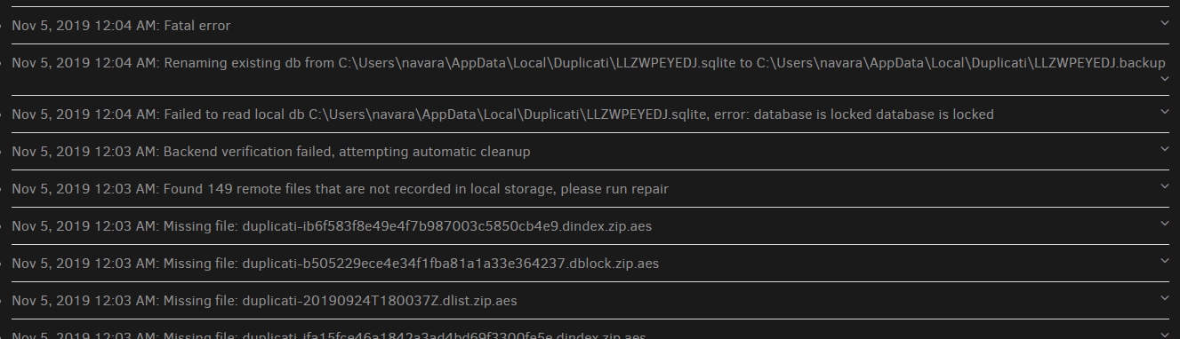

I would love to provide more logs, but there seems none to be generated. When I downgrade to v.28 and replace back the databases, application launches correctly and when commanded to backup, starts to verify only to die moment later when trying to repair DB. Note that only process locking that DB is duplicati process itself (as reported by process explorer, when I queried DB name)…
Stored log says:
System.IO.IOException: The process cannot access the file because it is being used by another process.
at System.IO.__Error.WinIOError(Int32 errorCode, String maybeFullPath)
at System.IO.File.InternalMove(String sourceFileName, String destFileName, Boolean checkHost)
at Duplicati.Library.Main.Operation.RepairHandler.Run(IFilter filter)
at Duplicati.Library.Main.Operation.BackupHandler.PreBackupVerify(BackendManager backend, String protectedfile)
at Duplicati.Library.Main.Operation.BackupHandler.d__19.MoveNext()
— End of stack trace from previous location where exception was thrown —
at System.Runtime.ExceptionServices.ExceptionDispatchInfo.Throw()
at CoCoL.ChannelExtensions.WaitForTaskOrThrow(Task task)
at Duplicati.Library.Main.Controller.<>c__DisplayClass13_0.b__0(BackupResults result)
at Duplicati.Library.Main.Controller.RunAction[T](T result, String& paths, IFilter& filter, Action`1 method)
at Duplicati.Library.Main.Controller.Backup(String inputsources, IFilter filter)
Live Verbose log says:
Backup’s logs says nothing about current backup attempt - contains only the last sucessfull.
