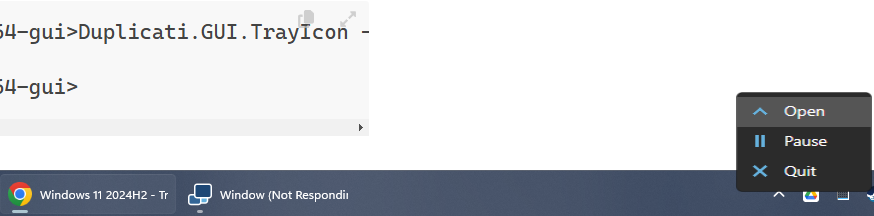

To add to that, I just tried again with the previously running Windows service and 2.1.0.3.
This time I didn’t put 2.1.0.2 in the mix. 2.1.0.3 put nothing to the terminal. Event may be:
(deleted since I can’t get it again)
based on the time. It’s still a guess, but the TaskBar icon and distorted TrayIcon menu happened.
Because I don’t like it telling Microsoft about crashes, I’ll do Task Manager kill instead, to remove both of those visual artifacts.
Windows Terminal looks like below. I start Windows service on port 8900 to keep it out of the way.
C:\Duplicati\duplicati-2.1.0.3_beta_2025-01-22-win-x64-gui>Duplicati.GUI.TrayIcon --no-hosted-server --webservice-password=password --hosturl=http://localhost:8900
Same issue occurs when using this approach.
  1. generated server on port 8111 using your command line
  2. attempted to connect to server on port 8111 using your other command line
  3. Tray icon launches as normal, when I right click and attempt to connect, it does not respond. (Took screenshot)
  4. No events in System, Security or App log appear related.
  5. Starting the server with --log-file=C:\duplicati-server.log generates logs (one line, the “No database encryption key was found” )
  6. Starting the tray icon with --log-file=C:\duplicati-tray.log generates nothing
Didn’t find any duplicati related events and could not get tray icon logging per other response just now.
I’ll tentatively retract my timing-related event, as I can’t get it again in another test run that failed.
