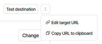

BTW if this is peeking inside an export file, you can also look at the GUI view:
Can’t get this. Please post simple and safe Destination setup that gets this.

Another good way to compare what a UI made is “Export As Command-line”.
One should be able to take the URL from that to BackendTool in an OS shell.
WebDAV Destination shows the usual format, before shell or JSON escapes.
