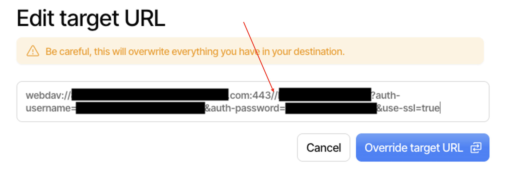

Hello,
After some investigation last night, I finally found the problem, which stems from a double slash in the target URL.
I haven’t touched this option recently, so I think it’s due to a version upgrade (as soon as an update for the Duplicati Linux server container is released, I automatically deploy it at 2 a.m. (I know it’s bad practice, but it’s for personal use and IT is my job and my passion, so debugging is actually quite fun).
@Kenkendk I wish I could give you the upgrade path that caused this, but unfortunately I don’t have that information.
In any case, I hope these few lines and the screenshot below will help anyone who encounters this problem.
The problem I encountered a few months ago may not have been related after all (but the symptoms were very similar).
