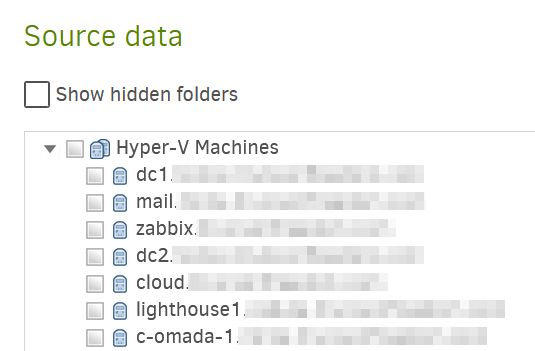

If you have Duplicati running on a host that has Hyper-V installed on it, you should see a section in the UI for it under the Sources tab for a backup job:
If you select a VM as a data source in the UI, Duplicati will attempt to back up all pertinent files, including the virtual machine definition files, disk images, and others. If you only want it to back up the .VHDX files, you would need to specific those manually.
