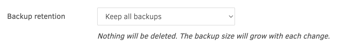

  • I set Backup Retention = Keep all backups.

Thanks @kenkendk. As part of my protection against malware somehow deleting my backups, I configured BackBlaze to never allow deletes by anyone for 1 year. So, yes, BackBlaze is likely denying delete.
But I configured Duplicati to never try to delete anything
I thought that would prevent the problem, but it doesn’t seem to.
Not really. You configured it to not delete backup versions. Read what was said before:
If an individual file needs to be deleted, it is marked in the database and (I think) deleted exactly as per original post, as part of cleanup before the backup itself is allowed to start.
