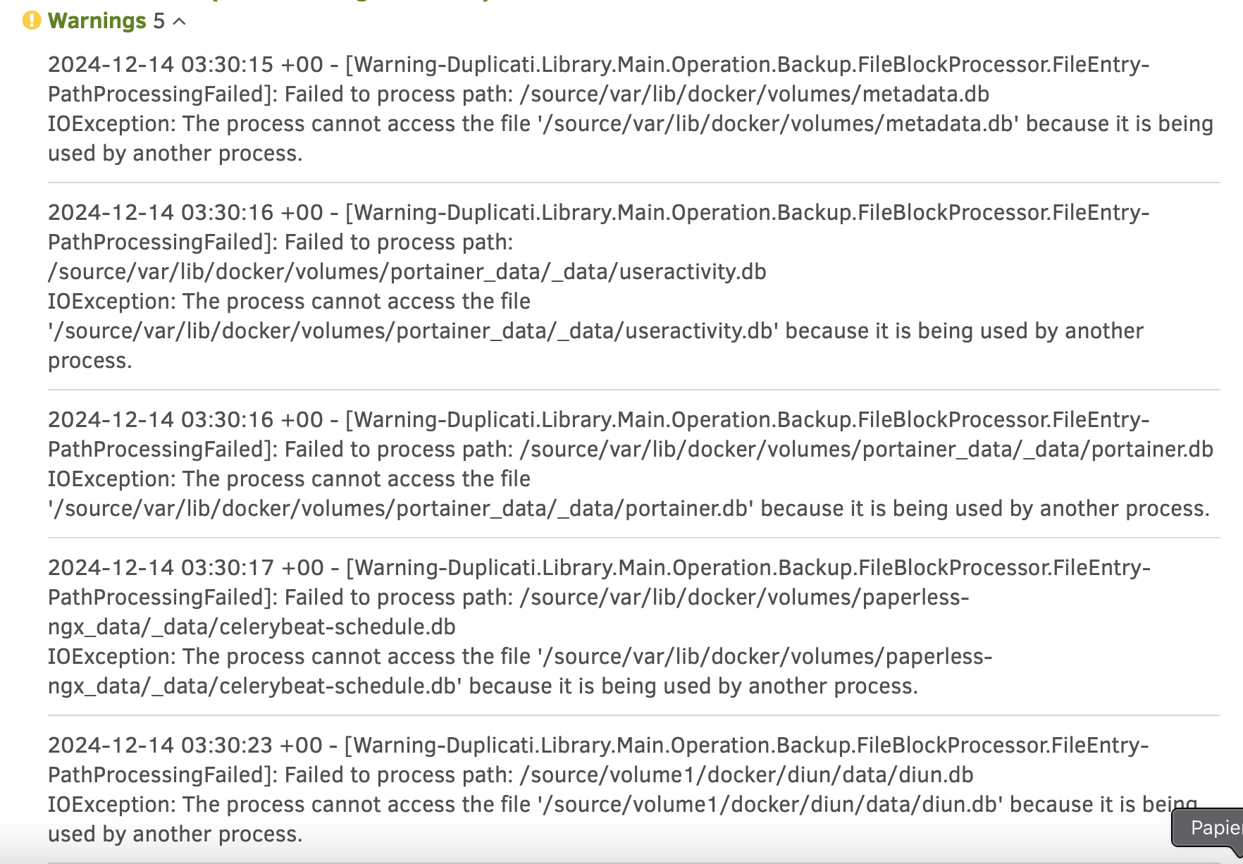

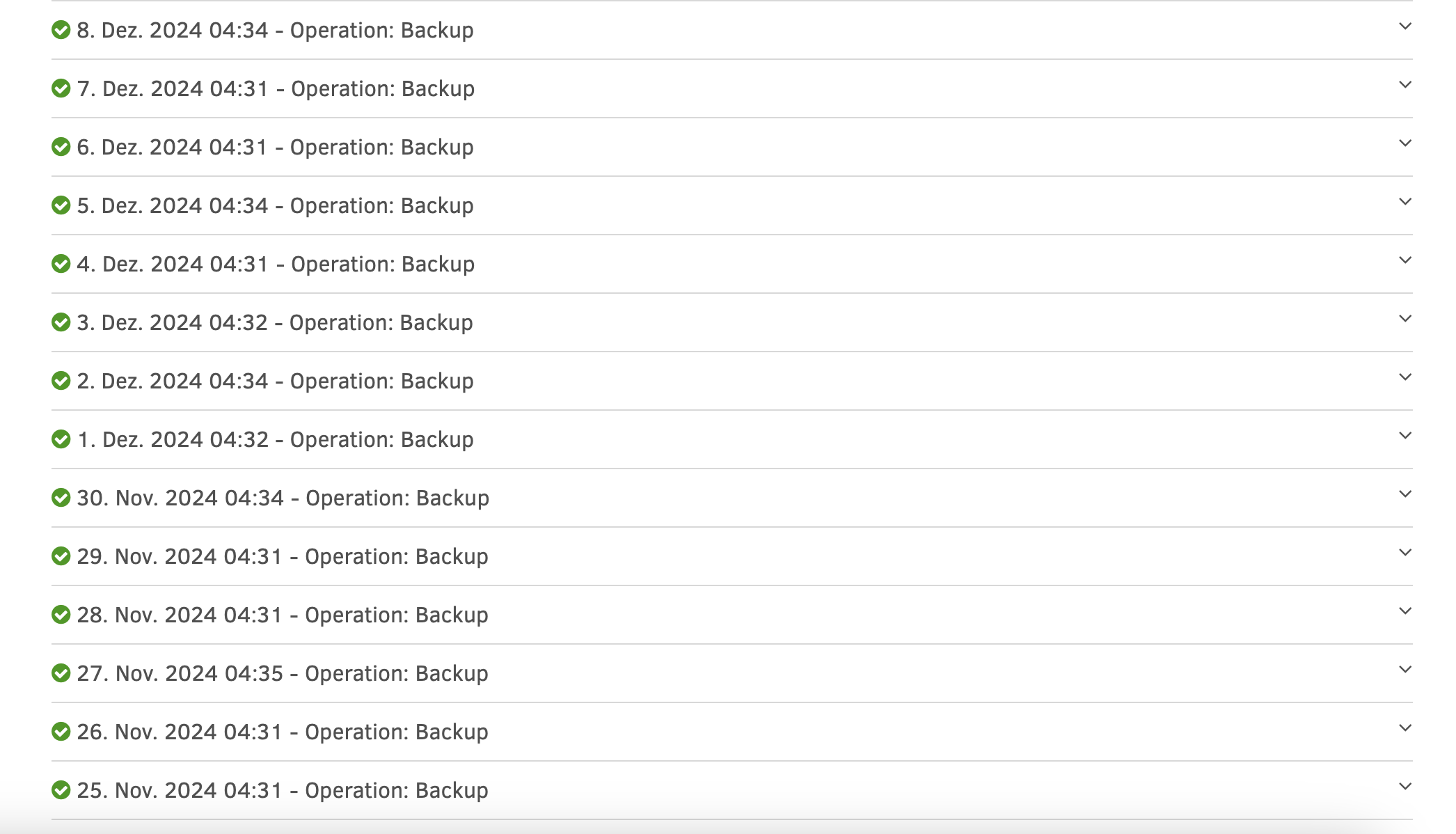

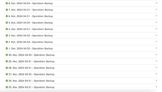

So I’ve been using Duplicati for months now, without any issues, to backup my Docker Volumes. Haven’t gotten any errors at all. However, after updating to the latest version I keep getting warnings that certain database files couldn’t be backed up because they were being used by another process. It makes sense, since Docker is running at the time of the backup, but I’m wondering why I get these errors now when it was working fine before. Is it just the warning that is new, and the files haven’t been backed up before either, or is there something new that prevents them from being backed up?

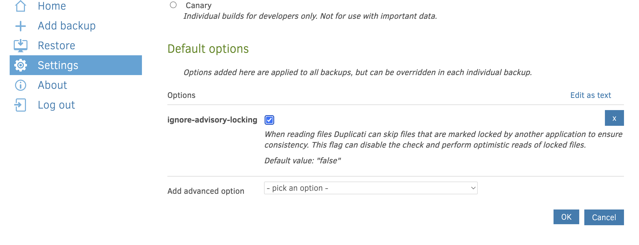

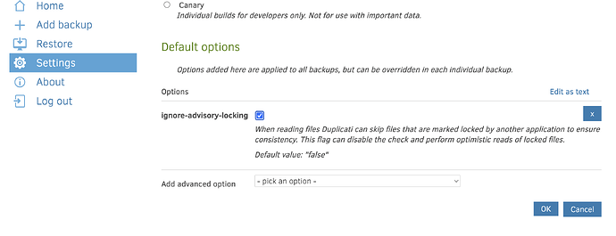

That depends a bit on how you are using Duplicati, but the most common place would be in the application settings (so it applies to all backups):
Make sure you check the box as shown in the image, and then click “OK”
