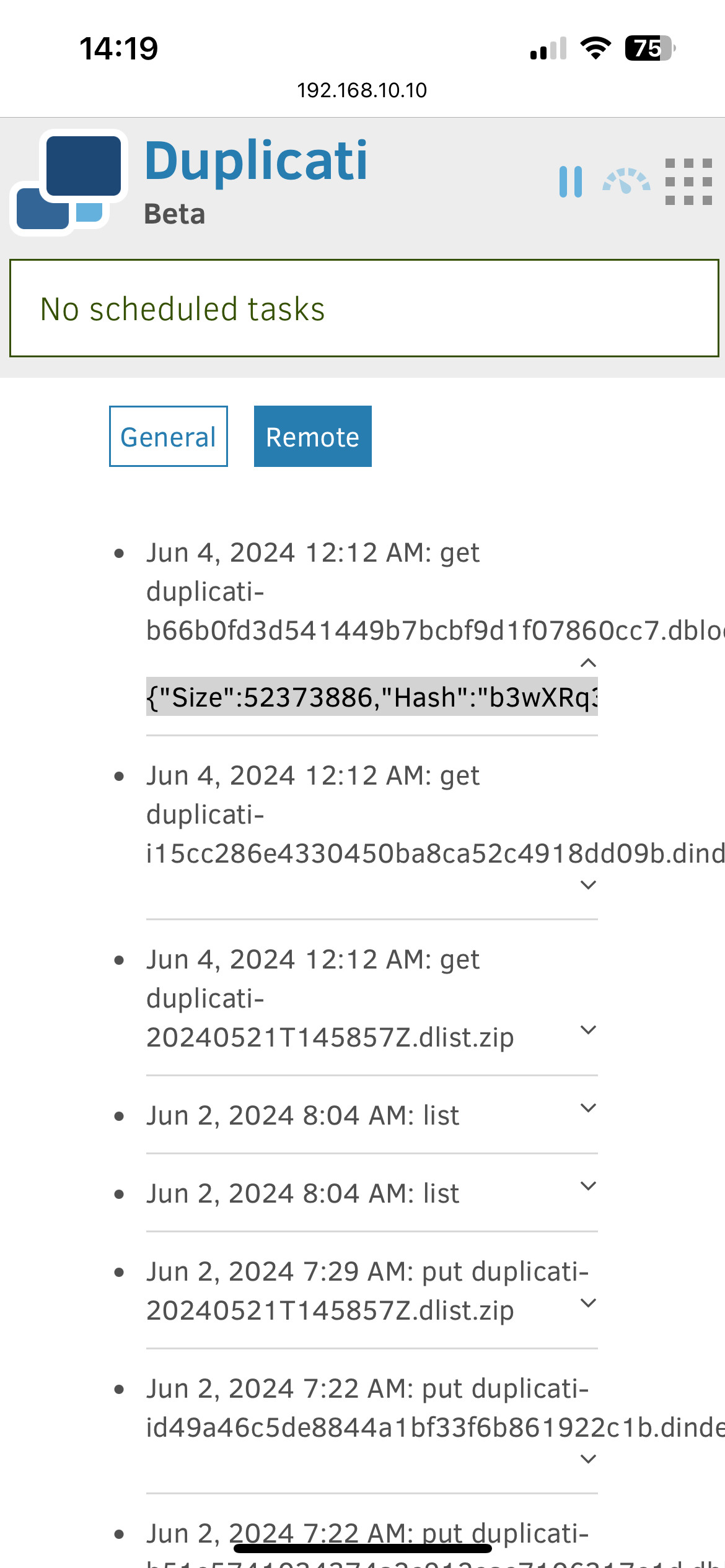

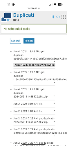

This is the log screen.
" {“Size”:52373886,“Hash”:“b3wXRq3X/1ADALGMpzLAqvwf7M4PD17J+OGnqEtpEBs=”} "

Before that is the list command I was asking about, and asking you to click on. You can do it now.
Seeing two is not normal. Possibly the second is a retry that apparently happened the same minute.
