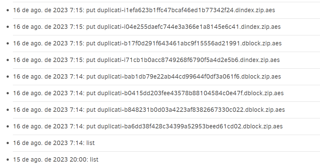

In my case, I have the backup programmed at 8:00 p.m. and it shows the input correctly if the computer was on. Or the next day I barely turn it on if it was off at 8:00 p.m the day before.
14 de ago. de 2023 20:00: list
Since we are here. I see that logs also appear on the remote when no backup is actually taking place.
The last backup was yesterday at 8:00 p.m. and I turned on the computer today at 7:14 a.m.
Are these reports normal on the remote even if no backup is running?
How do you know no backup was running? What did TrayIcon color or GUI show?
It looks like your 8 PM backup never really got going, but continued its job at 7:14.
When it finishes, look at the times in the job log and see if that looks correct there.
Or if you mean a full power off instead of sleep, job runs next time it has a chance.
Oh it can be yes! I didn’t know that Duplicati could take over an unfinished job.
or
Surely it was that.
Thank you
If you mean you might have powered off right as backup starts, I think (not positive) that Duplicati treats it as an unrun job that missed its schedule. Jobs that miss their schedule are run when Duplicati gets back.
