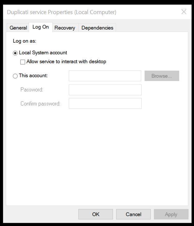

Did you have the service running under the “Local System” account or as the local “System” account? The first should just work, anything else would require a bunch of permission modifications and still probably won’t be enough, landing you right where you are.
I was always confused about the setup here and on the other systems (the ones that were working).
