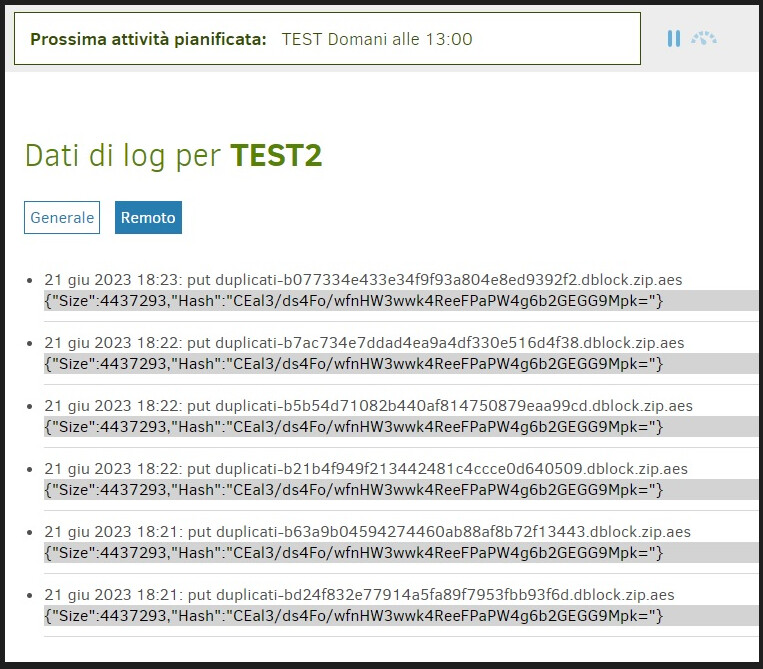

Good morning,
the initial configuration seems correct and the program connects to the cloud but unfortunately it doesn’t complete it and the error I am attaching appears.
I tried veeam and hyperbackup on the NAS and everything works fine. I don’t know.
The file you linked to is not readable for me but it don’t matter much, your reply confirms that Duplicati in its current state is unable to handle this provider, thanks.
Clipboard images can be posted to the forum. The downloaded after.jpg file shows this:
which doesn’t tell details, but looks like a dblock put failing and retrying default 5 times,
each time with a new name as expected, but with same content. Size and Hash match.
