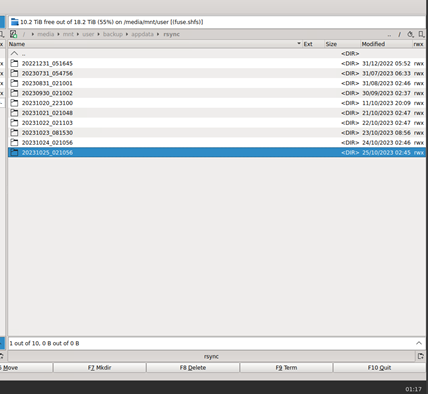

I run a daily rsync incremental backup locally. It generates a daily folder as such:
Once a week I want to push the latest folder to my cloud storage using duplicati. The folder name changes everyday according to the date; therefore I cant pick the source using the duplicati GUI. So I run a script that includes this:
