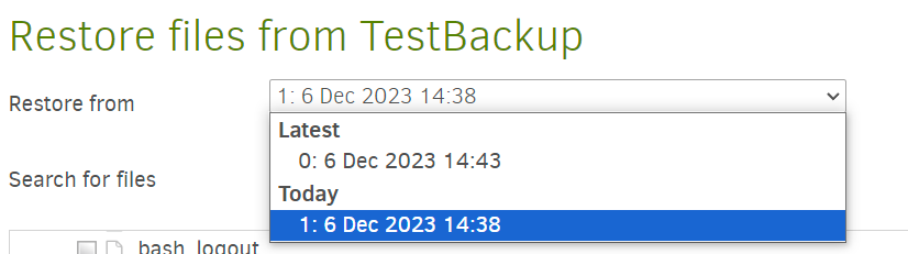

I run another backup. This shows me i have 2 versions of the backup.

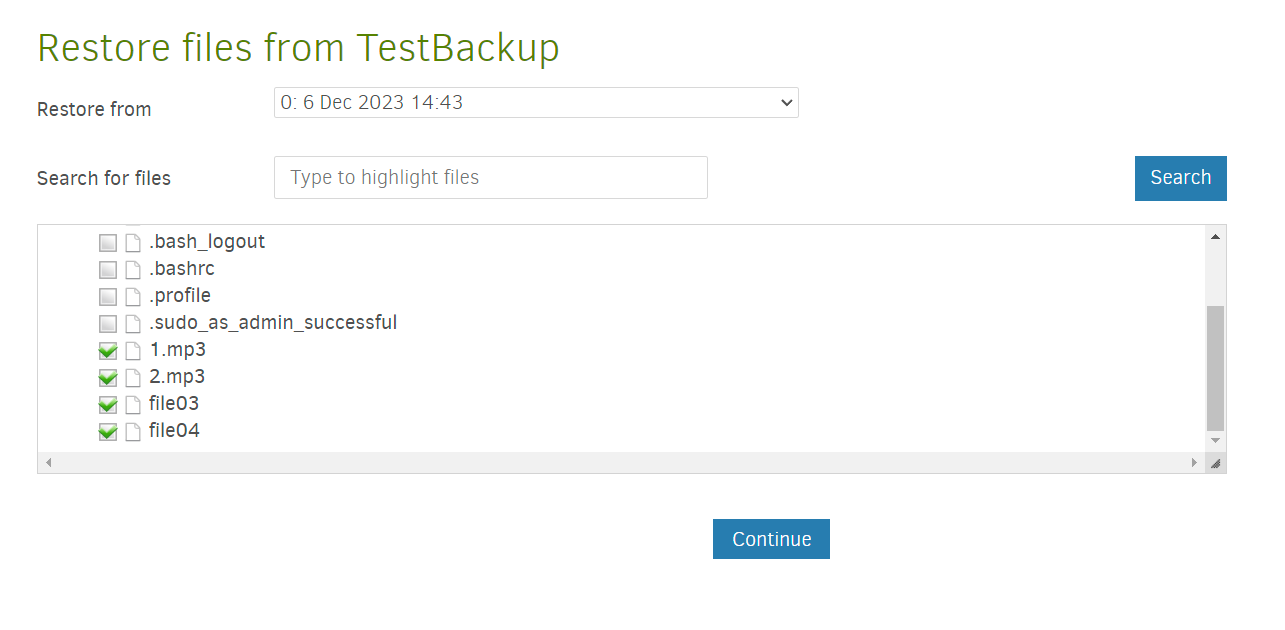

When i go to restore I only have two options, the FIRST and THIRD backup that was run.
The first backup shows the initail files from the first backup available to restore.
The third and most recent backup shows the files that were available at the time of the backup;
So i have no way of restoring files; 3.mp3; 4.mp3;

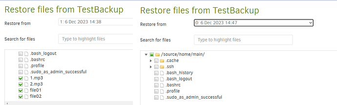

When i go to restore, i can only restore from the FIRST and FOURTH backup;
Below shows files available on FIRST (left) and FOURTH (right) backup
So, essentially, the files added before the SECOND backup are now no longer available to restore.
