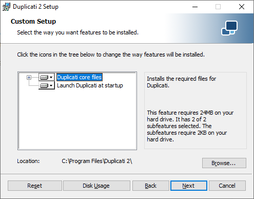

Hi @ts678
Thanks for the link.
But I would have to install Duplicati to make it work.
Regards
frd
You don’t need to install it on any C: drive. You do need to install it, e.g.:
If you don’t like the default install location (as shown above), change it.
