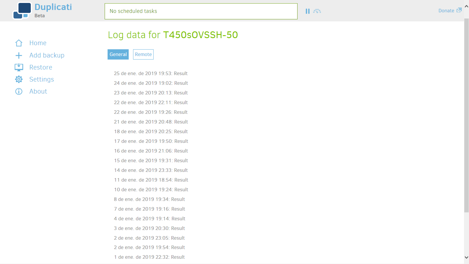

I have a little issue with custom backup retention policy
I have configured it as follow: 92D:1D,29W:1W,25M:1M
So I will have one backup per day for the past 92 days, one backup per week for the last six months and on one backup per month for a little bit more than two years.
The point is that duplicati do not keep a copy for each days:
On the screen shots you can see that duplicati did not kept a version for the 23, 17, 15, 11, 3 of January when a backup has been on these days. It seems that it kept a backup for each two days instead of a backup for each day.

Thank you for your quick answers.
I have check the logs, all not retained backups have ended the day they have start:
BTW, the warning is just because I was still using the obsolete “Verbose” option for log-level.
I was assuming the “Result” items (shown below the restore list) were from the log show run times.
It is correct:
Every backup listed as deleted incorrectly was less than 1 day from the previous one, thus was deleted according to the 1 day retention. 1 day is 24 hours or 1440 minutes or 86400 seconds. You can give the interval in those units with h m s respectively. Everything is converted to seconds. It’s not calendar time.
