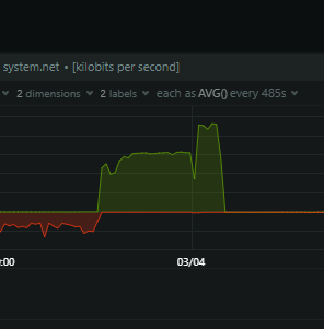

Restoring using the legacy method I saw that the network was on average 600Mbits, except for the last part. Probably because larger files were added to the repo last.
It took about 4 hours for the complete files to be written to the restore folder, and another 4 hours for the metadata update / file verification / whatever to complete.

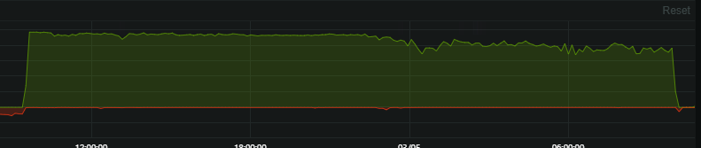

I then ran a restore using the new method.
I can see the network was fully saturated. The restore was started around 09:00 (AM). At midnight I checked progress and saw that I had 100GB and ~370,000 files remaining to restore.
At 9:00 (AM) I stopped the restore. I still had ~300,000 files remaining to be restored and 13GB.
