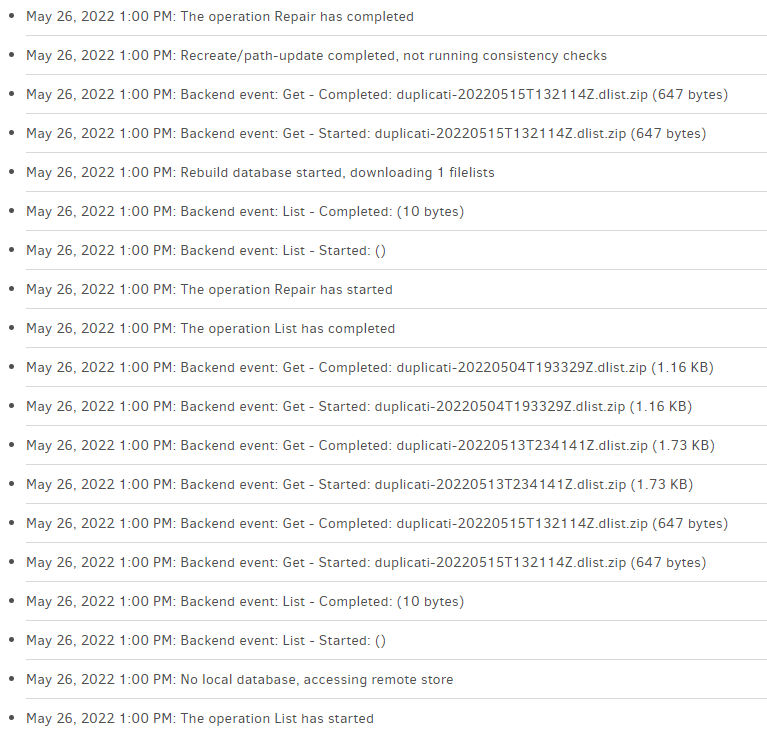

Now while I am trying to restore via GUI it just stay’s there saying like Waiting for task to begin and that i understand because i do not have the backup and restore point mapped to my DB which is why it keeps on waiting for a long. Below is the screenshot…
Is there a way to rebuild or modify something which can seek the information quick to process the data restore quickly.

What are you trying now? The screenshot’s 4 steps looks like a Direct restore from backup files.
That’s the usual way for a semi-quick restore without a configuration. I’m not sure why it’s stuck.
When you use the screen 2 Connect button, it builds a partial temporary database (not instant):
but this database is a temporary file so should be in a temporary file folder, not the /config folder.
Regardless, above was from a tab in About → Show log → Live → Verbose. You can test yours.
