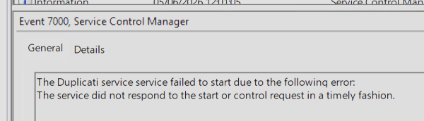

Having issues with the new installer when used from the command line by my software deployment service. It installed cleanly but the service that was already set up will not start. This is what it was and always was for a very long time:
It complains that Duplicati.WindowsService.exe does not exist, which seems to be the case.
So I tried renaming it to just Duplicati.Service.exe and the service starts but gets stuck as starting then stops after a few minutes. During that time the web UI is available and looks working as I could see the new welcome window in the browser. So the executables are still running but are not controllable with the service manager so I can only kill the processes to stop it now.
Any attempt to start the service is the same

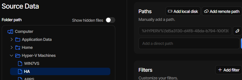

I’ve tested this release for the Hyper-V guest issue I’ve started experiencing since .103, still getting the same error. I’ve created a new test backup job in .104 as well as an existing job that worked in .102, both give the same error.

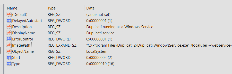

That sounds really strange, as Duplicati.WindowsService.exe is used for various things in the installer (if you enable the service there). I also tested many times with install/update scenarios, and I never experienced this.
Can you try an uninstall+install cycle to see if you get Duplicati.WindowsService.exe back?
Yes, that makes sense. The Duplicati.Service is just a generic runner, and it does not have the control interface that is needed to make it into a service. It can start, but it never signals Windows that it is running, so it won’t work.
We have not modified the Hyper-V code for this release, so not sure what is causing it.
Does it work if you downgrade to .102 ?
The error itself indicates that Duplicati tries to get the path to the VMs virtual disk, but gets a non-existing path back.
Hi, I posted this issue on the .103 release thread as well when that version was released. Same problem on .103 and .104. Downgrading to .102 the backup is sucessfull.
I first tried just to install over it but it was still the same, then I tried a repair, still the same and finally uninstall and reinstall but the file does not come back.
This is the original MSI log file and I can see the file is mentioned, it just isn’t getting placed on the server: 178501_Duplicati v2.3.zip (335.1 KB)
Probably a long shot, but did your antivirus scoop it up?
I’ve checked, nothing alerts and I only use MS defender, nothing else
