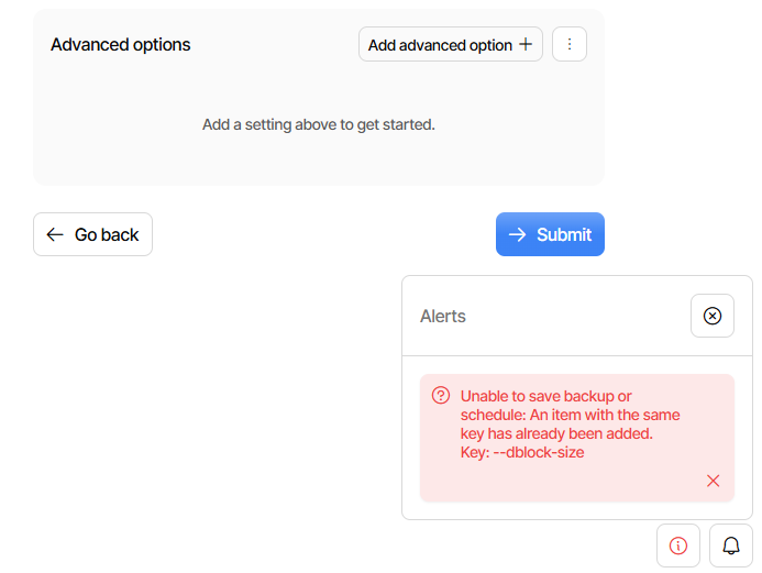

dblock-size is better, but there’s some confusion between the Remote volume size and dblock-size. Note I’ve found this confusing before, and might not understand it.
Steps:
In new UI, set dblock-size to 100 MB and save. Go to old UI and it’s there, BUT
Remote volume size is empty in both the value and units dropdown and complains
The chosen size is outside the recommended range. This may cause performance issues, excessively large temporary files or other problems.
Fix that, but set it to 101 MB to distinguish. Leave the 100 MB dblock-size, which does beg the question of which will rule, but that’s not new. Save, verify it returns.
Server DB now has (no dash) dblock-size 101MB and --dblock-size 100MB
Switch to new UI. Export As Commandline picks up 100MB. Edit picks up both as
dblock-size=101MB
--dblock-size=100MB
Submit and Edit. On the network, --dblock-size comes as 101MB then 100MB
Options as text shows both, but the 101MB becomes 100MB so now there are two
--dblock-size=100MB
--dblock-size=100MB
Options editor shows two as well, both 100MB. OK, x one away, they both vanish.

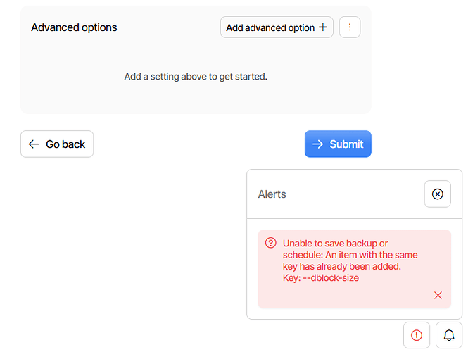

This seems wrong, but whether you add one again or leave none, Submit will fail:
GUI did not send any form of dblock-size, yet server response code complained:
“Error”: “Unable to save backup or schedule: An item with the same key has already been added. Key: --dblock-size”,
“Code”: 500
DB at this point contains
Unclear how to recover. Try legacy UI. Remote volume size has empty values.
dblock-size is 100MB, but delete that. Try doing Save, and get same result:
I can probably delete the job or edit the database directly, but I’d prefer not to…
Editing the database to delete one or all of the dblock-size variants solves this.
That’s not something I’d recommend to everyone, and better solution is sought.
I tested 2.2.0.3_stable_2026-01-06 a bit, but couldn’t steer it into a stuck config.
happens in DB. Old and new UI uses non-dash version as Remote volume size.
Old UI uses dash version as dblock-size. New UI doesn’t seem to have it in edit.
New GUI Commandline has it as dblock-size, as does Export As command line.
Maybe it is time that we add an alias to the option called “–remote-volume-size” ?
That is because the format treats block-size as a special property (no leading --), where ngclient now only treats it as an advanced setting. We need to capture the special property in ngclient and convert it to an advanced option.

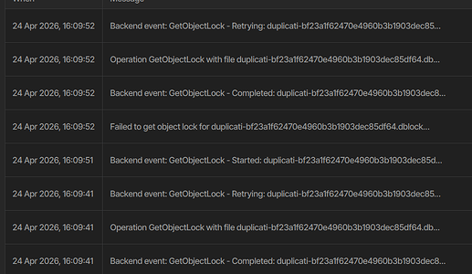

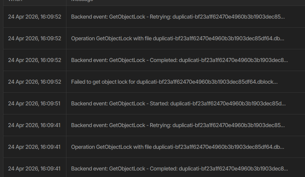

Second job, different machine, is a Wasabi S3 backup - I started a database delete/recreate and after several hours it been displaying
It’ s been doing this for several hours, I have no idea what the message means and it’s not a very big backup, 5 versions, 50Gb. Wasabi is working fine as other backups on other machines have all run throughout the day, so it’s not my connection.
Third job, same machine, is also with it’s Duplicati database backup, but as it’s stuck doing the above I’ve not had time to look at it. Will probably just delete it like I did to the one on the other machine.
The second job I really like to get fixed.
So this is reading the object locks to populate the database, and seemingly failing.
You can add --repair-refresh-lock-info=false to skip the lock information reading if you are not using remote locks.

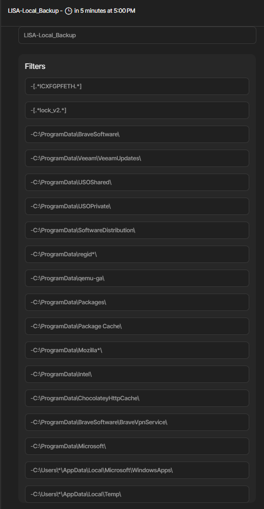

New UI doesn’t let me run Purge Broken Files comand-line, as it won’t remove the exclusions and there’s no way to remove them cleanly - clearing the fields makes no difference. Had to use the old UI.

You show 18 filters. Can you verify that there are not more, e.g. in new UI
scrolling, in an export as command line, or in old UI. This might be due to:
This got fixed in edit, but when I set 20 filters, Commandline only shows 18.
Clear everything in sight, set up F12 developer tools to watch, and in goes:
"--exclude=19","--exclude=20"
resulting in (justified given its input):
 The operation PurgeBrokenFiles has failed => Filters are not supported for this operation
 ErrorID: FiltersNotAllowedOnPurgeBrokenFiles
 Return code: 100
The job has 24 exclusions
I see the issue now. @ts678 was on the right path.
The view only shows the first ~18 filters so you cannot remove them all.
I have fixed it by using the same filter editor from the source page, so it will scroll and give you the “Edit as text” option.
