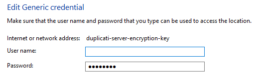

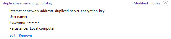

I can back up and restore the Windows credentials store (not sure if MS does it via MS account automatically, as it does with BitLocker keys), but it doesn’t allow viewing already saved passwords. Maybe there are tools for that?
Their credentials names/hosts (including com.elgato.philips-hue and similar), not sure if they’re used to authenticate access to the credentials. But the backup mechanism at least allows to store it outside the computer being protected by Duplicati, so there’s a way.

That could have been a little clearer. The name of the secret is duplicati-server-encryption-key. You can search for that name in your credential manager.
That is very true.
It was not the intention that the database should be used as a way to recover, but of course you can do that. I would then recommend that you ensure the database is encrypted, but you may want to either record the random encryption key, or pro-actively set up your own known key.
To set up the key, you can use the SecretTool:
Duplicati.CommandLine.SecretTool.exe set duplicati-server-encryption-key
You will then be prompted to enter the key. Do this before you start Duplicati, so the key is in place when Duplicati checks for it.

You can get that from the secret provider, look for duplicati-server-encryption-key

Cycle back to automatic PW to see if credential manager can really show it to me.
Nope, only asterisks, which is the same result as I get for lots of other credentials.
I spent hours earlier reading Internet posts saying it won’t show this. Does yours?
