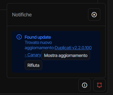

@kenkendk Hi, there is an alignment issue in the notification box at the bottom right. I am not sure if the English translation has the same issue.
Thanks for the swift feedback on the new UI, you can still cancel in the settings of the new UI - but im gonna make an option to cancel it in the topbar as well

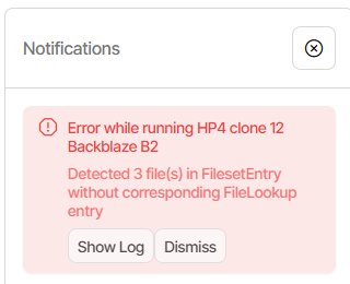

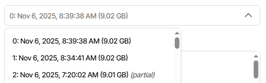

My B2 backup corrupted, probably from network glitch, but I’m not certain it’s a new issue.
After backup said it successfully completed, my run-script-after found missing blocks.

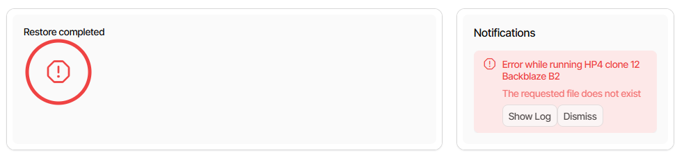

First look says there’s blocklist in a dindex which is pointing to State Deleting dblock block..

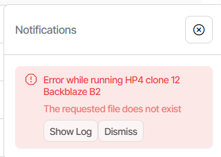

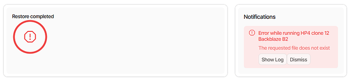

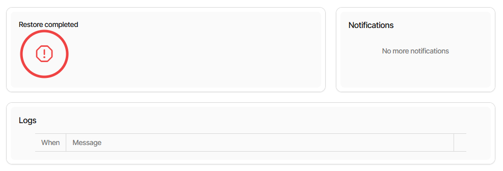

Confirming this wasn’t just a defect in my check, Direct restore got tree view fine, then got::
and Show log has no log to show, but that might just be the old Direct restore log limitation.

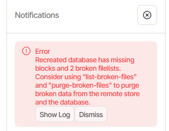

About → Logs → Stored has something which adds a bit more detail, including stack trace:
Duplicati.Library.Interface.UserInformationException: Recreated database has missing blocks and 2 broken filelists. Consider using "list-broken-files" and "purge-broken-files" to purge broken data from the remote store and the database.
   at Duplicati.Library.Main.Operation.RecreateDatabaseHandler.DoRunAsync(IBackendManager backendManager, LocalDatabase dbparent, Boolean updating, IFilter filter, NumberedFilterFilelistDelegate filelistfilter, BlockVolumePostProcessor blockprocessor)
   at Duplicati.Library.Main.Operation.RestoreHandler.RunAsync(String[] paths, IBackendManager backendManager, IFilter filter)
   at Duplicati.Library.Main.Controller.<>c__DisplayClass23_0.<<Restore>b__0>d.MoveNext()
   at Duplicati.Library.Main.Controller.Restore(String[] paths, IFilter filter)
   at Duplicati.Server.Runner.RunInternal(Connection databaseConnection, EventPollNotify eventPollNotify, INotificationUpdateService notificationUpdateService, IProgressStateProviderService progressStateProviderService, IApplicationSettings applicationSettings, IRunnerData data, Boolean fromQueue
The reporting during the restore looks a little off, with no logs. What’s the notifications note?

Testing my newly discovered broken file, an attempt to restore glogg.ini got:
which is about what I’d expect due to the missing dblock file (in State Deleting).
as usual for Canary gives “Show Log” button that goes to job log that isn’t there.
Server log has the error, but it’s not that interesting if one happens to expect it…

A popular and simple response to mystery issues might be a Repair. It fails with:
No job log as usual. Server log doesn’t clarify a whole lot more, and lacks names:
System.Data.ConstraintException: Detected 3 file(s) in FilesetEntry without corresponding FileLookup entry
   at Duplicati.Library.Main.Database.LocalDatabase.RemoveRemoteVolumes(IEnumerable`1 names, CancellationToken token)
   at Duplicati.Library.Main.Operation.FilelistProcessor.RemoteListAnalysis(IBackendManager backendManager, Options options, LocalDatabase database, IBackendWriter log, IEnumerable`1 protectedFiles, IEnumerable`1 strictExcemptFiles, VerifyMode verifyMode, CancellationToken cancellationToken)
   at Duplicati.Library.Main.Operation.RepairHandler.RunRepairRemoteAsync(IBackendManager backendManager, CancellationToken cancellationToken)
   at Duplicati.Library.Main.Operation.RepairHandler.RunAsync(IBackendManager backendManager, IFilter filter)
   at Duplicati.Library.Main.Controller.RunAction[T](T result, IFilter& filter, Func`3 method)
   at Duplicati.Library.Main.Controller.Repair(IFilter filter)
Profiling log shows no file names, and source looks like it just doesn’t show them.
Arguably there’s not much that typical users could do with the file names anyway.

Question is – how to fix this? Recreate doesn’t work, at least on initial try of that.
Run list-broken-files to see if it has any files to flag. Sadly it doesn’t notice:
   Listing remote folder ...
 Return code: 0

I’ll check Restore to confirm my last two backups (ID 444 and 445) still exist. Yes:
and one can also see the 7:20 one that had the network glitch that began all this.

From backup 3, 1 dblock, 1 dindex, 1 dlist, so 3 files.
11/06/2025  08:41 AM            50,493 duplicati-bd04a1cb957ae4817b4c7eadc7f596567.dblock.zip.aes
11/06/2025  08:41 AM             1,757 duplicati-i09a586d34d984a59a50c30c6a50af7be.dindex.zip.aes
11/06/2025  08:41 AM           920,429 duplicati-20251106T133938Z.dlist.zip.aes
and then doing Recreate, however I see that the last time I had to do Recreate:
Duplicati didn’t stop on dblock Put fail, and Put dlist using it. Later on, some successful B2 Put didn’t actually leave files
instead of deleting new files beforehand (which can be riskier if a compact ran), Recreate probably helped to break the deadlock, to allow the repair tools to run.
EDIT 9:
Rather than experiment further on the actual B2 backup, I tested on a local copy.
Unsurprisingly, Recreate couldn’t find what it needed in dindex, so got all dblock.
This would bother some due to time and maybe fees, but I always rclone to local.
Unsurprisingly, Recreate remained unhappy due to the missing blocks in backup:
Recreated database has missing blocks and 2 broken filelists. Consider using “list-broken-files” and “purge-broken-files” to purge broken data from the remote store and the database.
The two broken filelists were the versions after the run that failed due to network.
purge-broken-files on the recreated DB runs fine, then the Recreate runs fine.
Resetting the local copy from the remote, then deleting the newer files after some careful studying also resulted in a clean Recreate without any dblock “download”, however it sacrifices all of those newer versions instead of just purging breakages.
Nice move would be to fix the bug causing the corruption. Tools could improve too.
