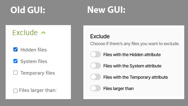

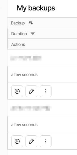

This is the first beta I’ve tried since the stable release. I noticed that if I exclude hidden files AND system files, hidden files aren’t excluded in the backup.
There is also a small issue with the new GUI. This is what I see when editing the saved backup jobs:
Welcome to the forum @HD1080ide and thanks for the report.
The first problem more generally looks like the exclude-files-attributes option no longer understands its documented comma-separated attributes as of 2.1.0.119_canary_2025-05-29.
Test was an Export As Command-line and --console-log-level=verbose to watch excludes during backup of a folder with files with the different hidden and system files applied with attrib.
2.1.0.118 worked, and then 2.1.0.119 changed a lot of the Options.cs code. Maybe it broke this.
The GUI problem looks like an inability of the new GUI to read back any of the Exclude settings. Although it seems able to set them, next job edit risks losing them, as it doesn’t think they’re set.

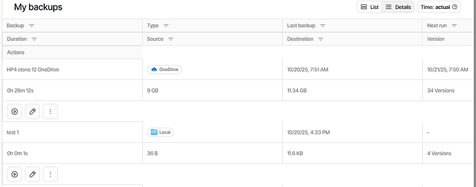

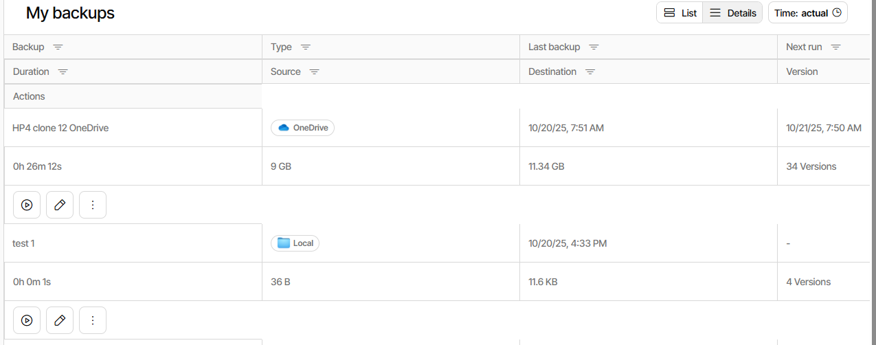

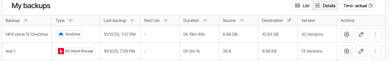

While I’m here, I’ll ask dev if it was intended for Details view to be three-line view instead of one:
2.1.2.1:
2.1.2.3
While this gives more horizontal space in the boxes, it’s harder to read, and the action buttons (which at least don’t risk falling off right edge of the screen) don’t belong to nearest job name. Example is if you wanted to run test 1, would you use button above its name? It’d be wrong.
@HD1080ide, I have registered this is as an issue.
That is not intended at all.
I have seen something similar before, and it was caused by not having a schedule on one of the backups, and the render code expecting a value. Can you see with DevTools if you get some kind of error that can help trace what is causing this?
I tested on my machine with backup that has no schedule and it looks correct, so perhaps something else is triggering it?

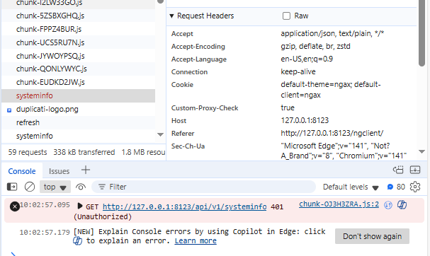

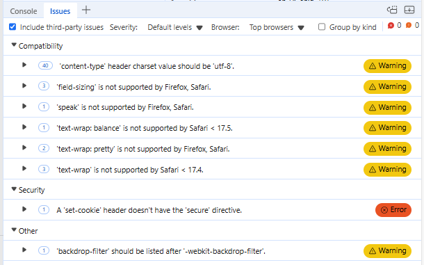

The main oddness I see with refresh button is a systeminfo GET doesn’t authorize first time:
Also some Issues:
Oddness repeats on repeated use of refresh button. I might experiment with the login options.

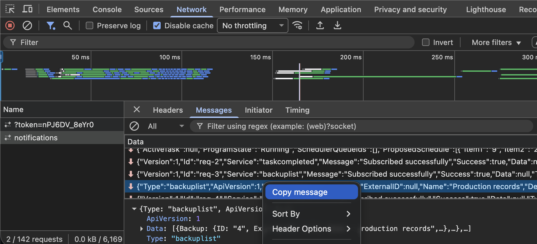

Can you help me with the following steps:
  1. Activate the developer tools
  2. Look at the network tab
  3. Look for “notifications” (you can filter by WebSocket or Socket)
  4. Open the “messages” sub-tab
  5. Look for “Type: backuplist”
  6. Right click and choose “Copy message”
  7. Share that message with me (edit for privacy or send as PM)
It looks like this:

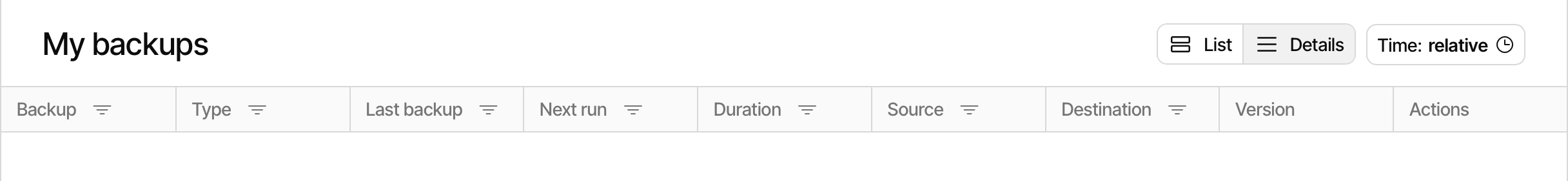

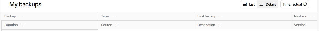

I avoided privacy concern by using new temporary server database. It’s a minimal test case:
The backuplist:
{"Type":"backuplist","ApiVersion":1,"Data":[]}
The display:
With that data, mine looks correct:
I tested in Safari and Chrome, so I would expect that Edge works the same?
That was Edge.
This is Chrome (also rendering as 3 lines):
This is Firefox (also rendering as 3 lines)
If it matters display resolution is 1920 x 1080.
In case the video hardware has an effect, I tried VirtualBox Firefox and Chromium. Same render.

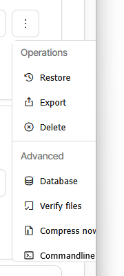

The “List” View looks better. But the context menu of the “tree vertical dots” menu reaches outside the browser window in Firefox. In Chromium it looks fine.
