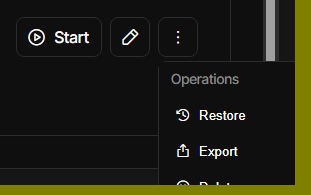

Cosmetic issue, when I try to use the menu for the last job listed, so the list is at the bottom, then menu cannot be scrolled:
