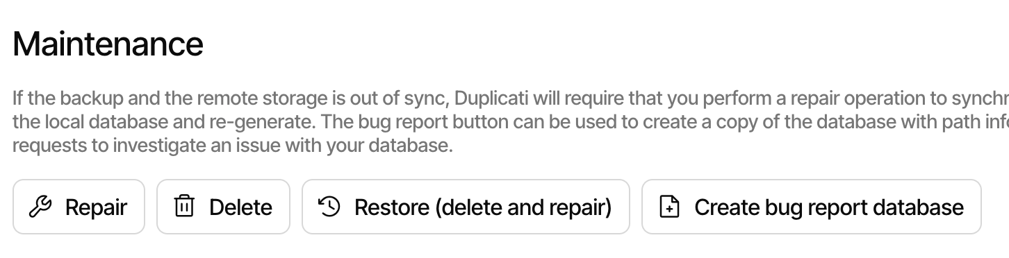

BTW, any chance that Repair could be a standard command now without needing to go through the command-line menu? I can’t be alone in needing to do this almost daily as my installations gradually fixes past backup data?
That sounds like something we need to fix ASAP.

It is that already. Pick the “Database” menu from the overview, then there should be a “Repair” button:
That is the new masking that needs to be dealt with for the commandline page. I will fix it.

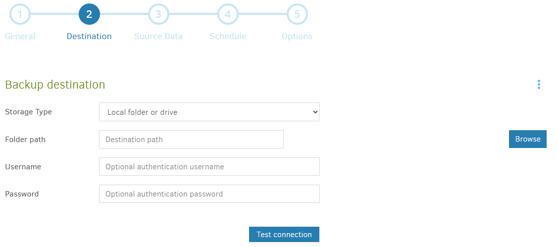

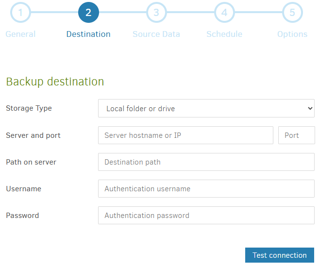

Compared with 2.1.1.102, ngax “Local folder or drive” now has “Server and port”?
It also provides no way to browse folders. Here’s 2.1.1.102 in “Manually type path”:
Ouch. A small cleanup wiped all the editors, so no matter what destination you choose, it uses a generic view.
I have a fix for it ready.
